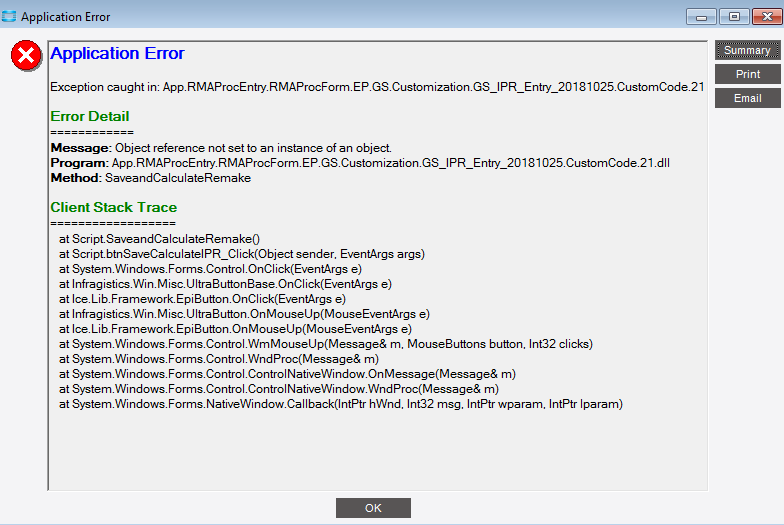

I have some kind of issue in my conversion I’m assuming. Anyone have any ideas? Here is the error:
My BAQ column I am trying to return is formatted as “Decimal”
I am trying to insert that value into a number editor box.
My code is:

neTotalRemakeAmount.Value = gridRemakeData.ActiveRow.Cells["Calculated_TotalRemakeCost"].Value;
Is there an ActiveRow at this point?
Maybe try getting the first SelectedRow? Also, is that column name correct?

Okay, I got this to work. It wasn’t finding a value in the grid was the problem. Here is the code that is working:
