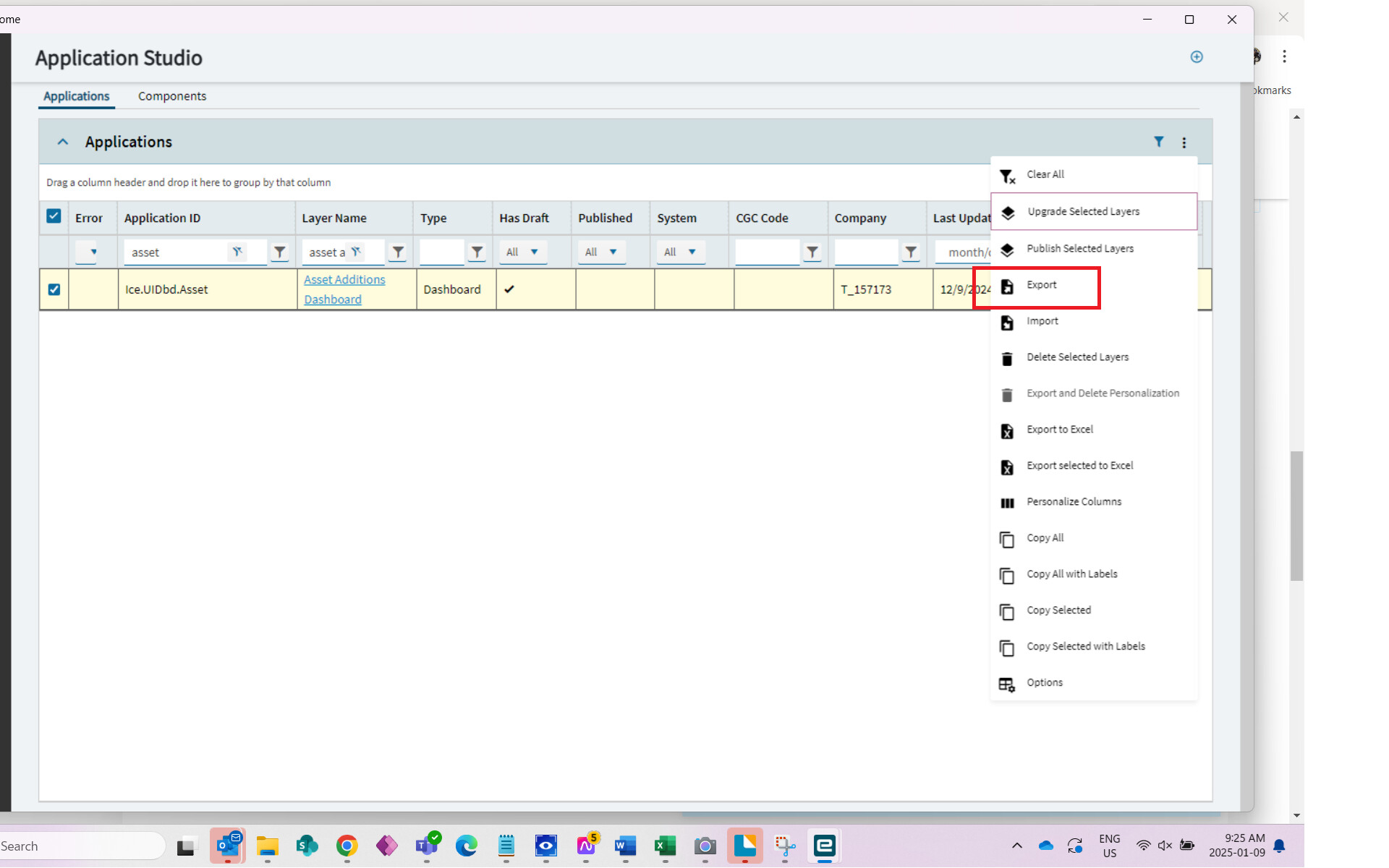

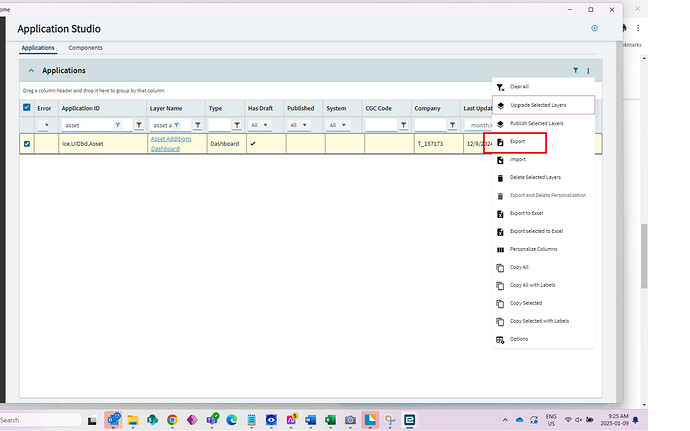

Youcan also export the dashboard from the Application Studio screen where it lists the applications. I have tried this but only once . We are not using Application studio live yet. I’ve just moved the one dashboard over.
