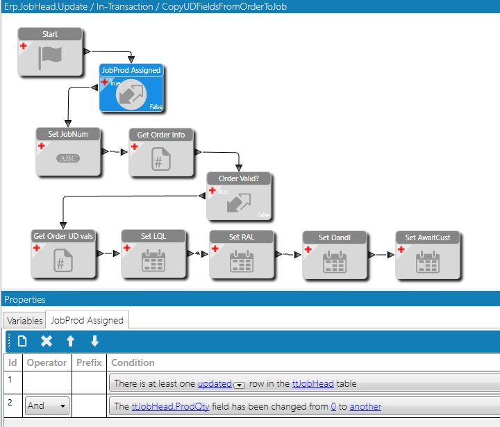

We do similar. For job creation, we use a data directive on JobHead to pull data. This works for multiple jobs:
//Get the order info
var Result = (from t1 in Db.JobProd
where t1.Company == callContextClient.CurrentCompany
&& t1.JobNum == gJobNum
select new{t1.OrderNum, t1.OrderLine, t1.OrderRelNum}).FirstOrDefault();
//Set the global variables to those found values
if (Result != null) { //Will be null if no more rows
gOrderNum = Result.OrderNum;
gOrderLine = Result.OrderLine;
gOrderRelNum = Result.OrderRelNum;
} else {
gOrderNum = 0;
gOrderLine = 0;
gOrderRelNum = 0;

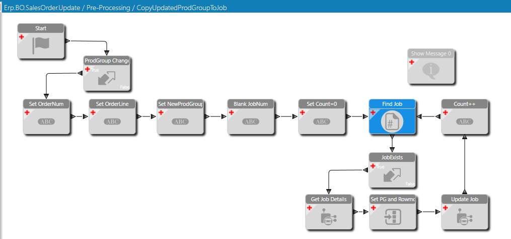

For updates, we use method directive on SalesOrderUpdate to push new data. This is for updating product group.
//Get the next Job Number that need changing of Product Group
var JobNum = (from t1 in Db.JobProd
&& t1.OrderNum == gOrderNum
&& t1.OrderLine == gOrderLine
&& string.Compare(t1.JobNum,gJobNum) == 1 /* StringCompare = 1 if s1>s2 */
orderby t1.JobNum
select t1.JobNum).FirstOrDefault();
if (JobNum != null) { //Will be null if no more rows
gJobNum = (string)JobNum;
} else {
gJobNum = "";
This is great, are you able to show what code you have in “Get ORder UD vals” in your first BPM?
Sure. This is very specific to us though.
//Get the order LQL
var Result = (from t1 in Db.OrderHed
select new{t1.QALevel_c}).FirstOrDefault();
gQALevel = Result.QALevel_c;
} else {
gQALevel = "";
//Get the order RAL #
var Result2 = (from t1 in Db.OrderDtl
select new{t1.ShortChar01}).FirstOrDefault();
if (Result2 != null) { //Will be null if no more rows
gRALNum = Result2.ShortChar01;
} else {
gRALNum = "";
//Get the order D&I and AWaiting Customer Equipment values
var Result3 = (from t1 in Db.OrderRel
&& t1.OrderRelNum == gOrderRelNum
select new{t1.DandI_c, t1.AwaitingCust_c}).FirstOrDefault();
if (Result3 != null) { //Will be null if no more rows
gDNI = Result3.DandI_c;
gAwaitCust = Result3.AwaitingCust_c;
} else {
gDNI = false;
gAwaitCust = false;

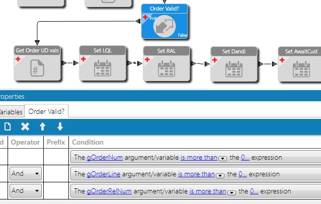

I just had one more question about your order validation condition. What did you use for that?
