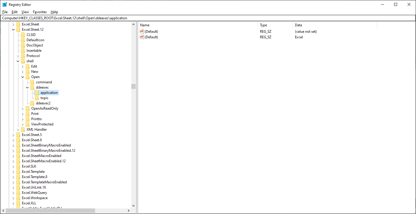

Managed to solve my problem today, here is what I did.
  1. Open regedit
  2. Navigate to HKEY_CLASSES_ROOT\Excel.Sheet.12\shell\Open
  3. Create key ddeexec. Set its default value to [open("%1")]
  4. Go inside new key “ddeexec”
  5. Create key application. Set its default value to Excel
  6. Create key topic. Set its default value to system
  7. Navigate to HKEY_CLASSES_ROOT\Excel.Sheet.12\shell\Open\command
  8. Make sure default value ends with → Excel.exe" /dde
If there is anything else, remove it
This solves the problem to .xlsx files. Did the same on “Excel.Sheet.8” key to solve the problem for .xls files.
Also, I tried the next on a different computer and worked as well:
  1. Exit all instances of Excel.
  2. Start Registry Editor:
  3. Locate and select the following registry subkey: HKEY_CURRENT_USER\Software\Microsoft\Office\16.0\Excel\Options
  4. On the Edit menu, point to New, and then select DWORD Value.
  5. Enter DisableMergeInstance, and then press Enter.
  6. In the Details pane, right-click DisableMergeInstance, and then select Modify.
  7. In Value data, enter 1, and then click OK.

I was wondering if you could share a screenshot of the keys you’ve setup. I tried to follow your instructions as much as I could but I am not sure if I’ve done it right because it didn’t really work for me. I think i may have misunderstood key application and key topic steps.

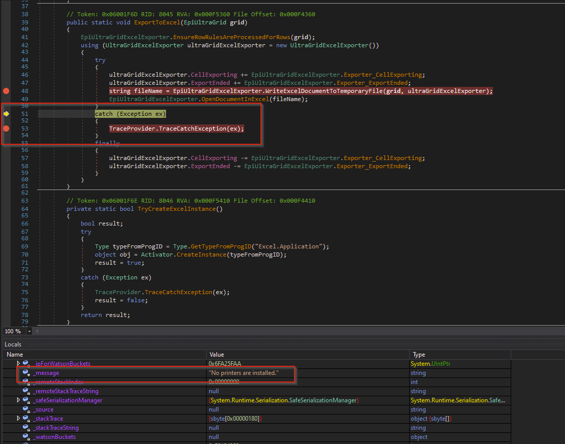

@jgiese.wci and I had an issue where Copy to Excel would create the file, but never actually open Excel.
Turns out if you have no Printers or your Default Printer is not accessible, there will be a silent exception happening in the Classic Client.

I revisited this today as someone new reported it, changed the Default Printer to a the OneNote one… worked straight away!
Thanks you again… :grinning: :grinning: :grinning:
Brilliant, I’ve just fixed 2 PC’s which had issues with this. Set the ‘Microsoft Print to PDF’ as the default printer and started to work immediately. Thanks for posting this!
