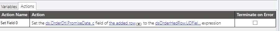

I have created two post-processing method directives on, Erp.BO.SalesOrder.GetNewOrderDtl and Erp.BO.SalesOrder.GetNewOrderRel. I am trying to set OrderDtl ud date field to the OrderHed UD date field, but get the error “There are no records in the table” whenever I point to anything in the OrderHed table. For the OrderRel UD date field, I assigned the value from the OrderDtl and it worked fine. I just can’t get the value from the OrderHed.

You won’t find OrderHed data in the ds for the GetNewOrderDtl and GetNewOrderRel methods since it’s just returning a fresh OrderDtl or OrderRel row, you’ll need to go to the database for it. I have some BPMs doing similar stuff, here’s how I structure them (in this case for GetNewOrderDtl):
foreach (var OrderDtl_row in ds.OrderDtl.Where(x => x.RowMod == "A"))
        // Fetch the header-level value you want to copy from the database
        string headerStringField = (
            from OrderHed_row in Db.OrderHed
            where OrderHed_row.Company == callContextClient.CurrentCompany
                && OrderHed_row.OrderNum == orderNum // (orderNum is a parameter)
            select OrderHed_row.StringField
        ).FirstOrDefault();
        // Assign the corresponding field in OrderDtl to the fetched value
        if (headerStringField != null)
            OrderDtl_row.StringField = headerStringField;

Thanks, I was able to get the field off the order header. Moving on to the next step.
