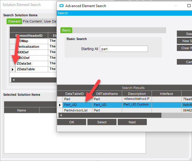

Create a solution, add ZDataTable element, find your UD tables, and add them to the solution. Then, you can install that solution into any environment.
Thank you for the help Guys! I did the solution method and it worked great. Thank you. :blush:
