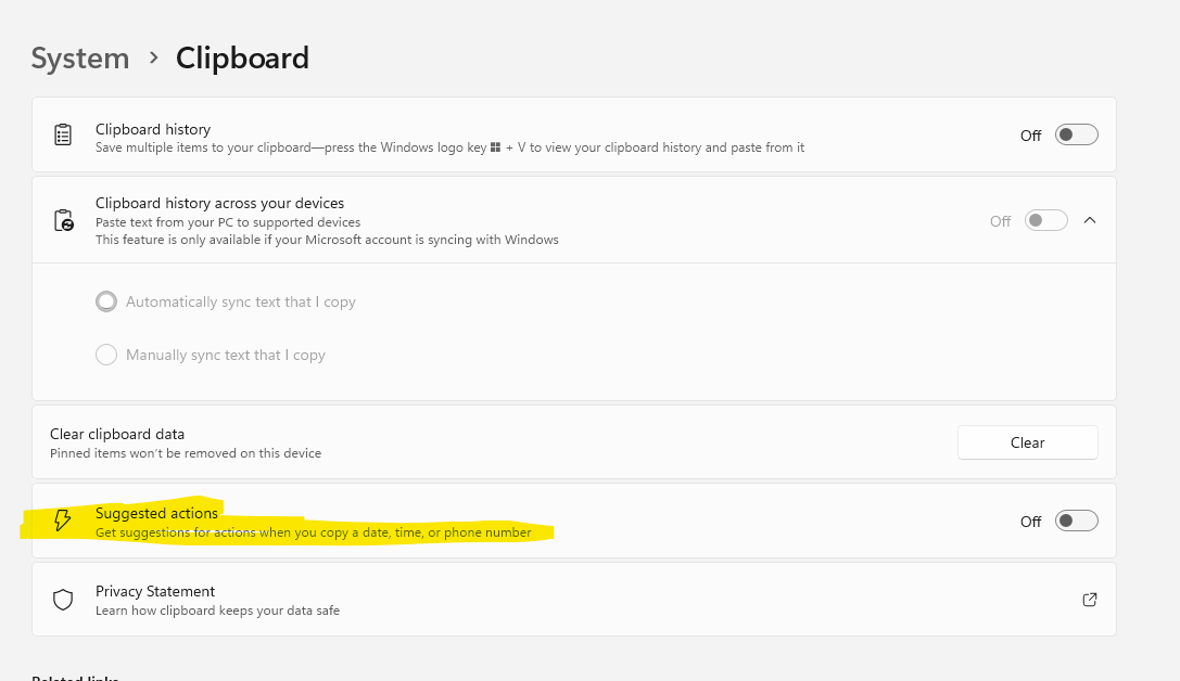

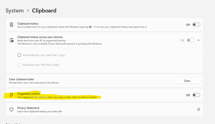

I can add that on W11 I have the same dashboard copying issues. However, if I use a clipboard manager application like Ditto on W11 then it copies correctly without skyrocketing memory usage and locking my Epicor client.
It’s possible something is goofed up in the W11 clipboard. The only thing I saw in Microsoft’s support page is that W11 supports “Automatically sync text that I copy” while it’s not listed for 10. Not sure if it’s the issue at all, it’s just what I found.
You sir are correct! Thanks, the issue does appear to be with Windows 11 clipboard as I have confirmed once I installed Ditto I no longer need 10GB of RAM and have to wait for over a minute to copy 5 rows out of a dashboard with 6.5k rows :slight_smile:
