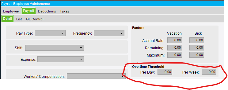

Take a look at Employee Maintenance, and the Production Info tab. Look under Shift, and then make sure your shifts are defined properly. You can setup a shift (say 630am to 300pm), then turn on a differential rate to apply overtime.

we do not have payroll in Epicor, all we have is same sort of calendar to setup the clock-in and clock-out using the Data Collection portal in Epicor
