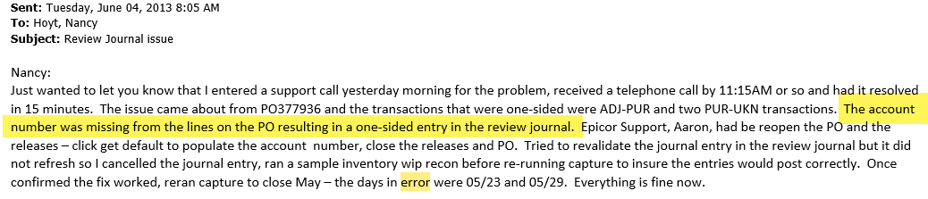

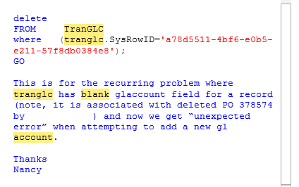

Back in E9 we had similar difficulty stemming from AP invoicing where tranglc has blank glaccount field due to a bug. It caused review journal duplicate error and also gave us difficulties with creating new gl accounts.
See below for what it looked like. Perhaps this bit of info can help you find your error.
