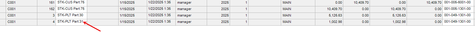

Getting a Transaction does not balance error but… its COS / WIP I’m not sure what power I have to modify what it does. Any ideas?
Well I think I found the transactions… WTH is STK-PLT… Plant to Plant transfer… that’s a new one… oh boy

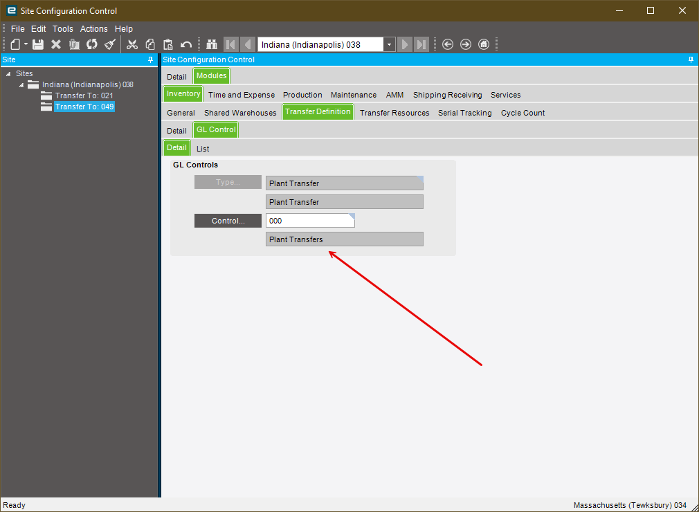

I may have found the culprit, missing Control Code in Plant Transfer Site Settings

That would be it!
