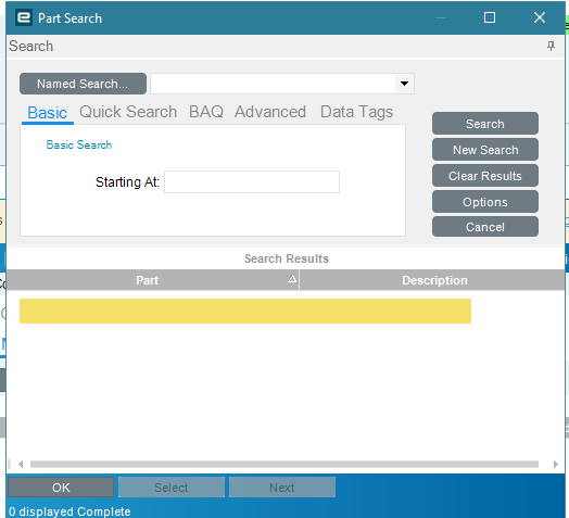

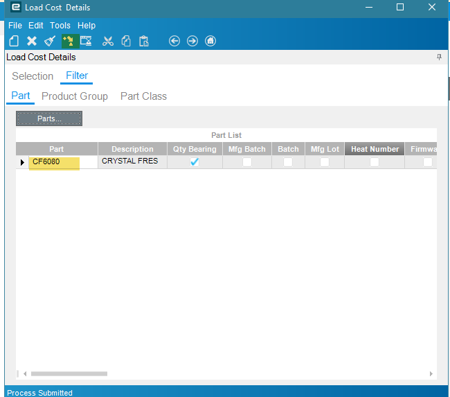

I have a part with a revision in 2 sites : CL01 and UL01.
A new Method of Manufacturing was created for another site GL01.
I tried to roll up the part for this site. I searched, selected the part and clicked processe to load the cost details but nothing appeared when I look for the part information under Manufactured Parts search.
The BOM is Ok in the 3 Sites. The MOM is also Ok in the 3 sites.
My questions is:
Do we need to roll up when a new MOM/Revision is created for a part, or we don’t?

Is the part marked as manufactured in the site you are searching?
Check Part>Site tab in part maintenance.

Short answer is yes, you need to do a roll up when you have a new Method.
Also consider the fact that each site can have 1 cost ID or each site can have a specific cost ID

I think that the issue is the Cost ID.
Each site have a specific Cost ID as @arrobatony mentioned.
Working on fixing this.
Thank you
utaylor
(Utah Taylor)
August 13, 2024, 6:33pm
10
Each site needs to have a different ID if you want it to have a different cost.
