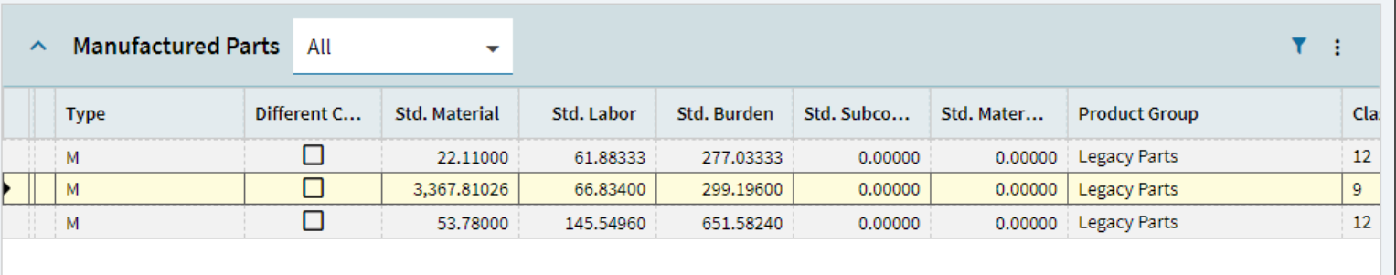

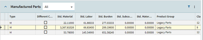

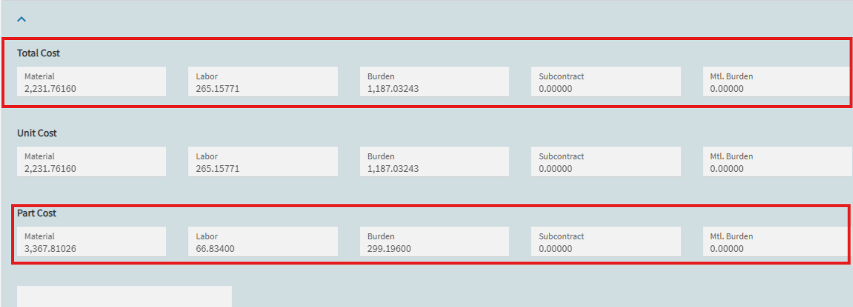

we ran the cost rollup but part tracker cost and BOM cost report shows difference…Whereas, When I checked in the manufacturing tab it shows correctly but not in view cost tracker and BOM cost report
Are you multi site, if so ensure that you have actually selected the correct part/site for cost comparison. I know in Classic this can be a trap for users when using the part tracker an looking at costs. It may be the similar in Kinetic.
