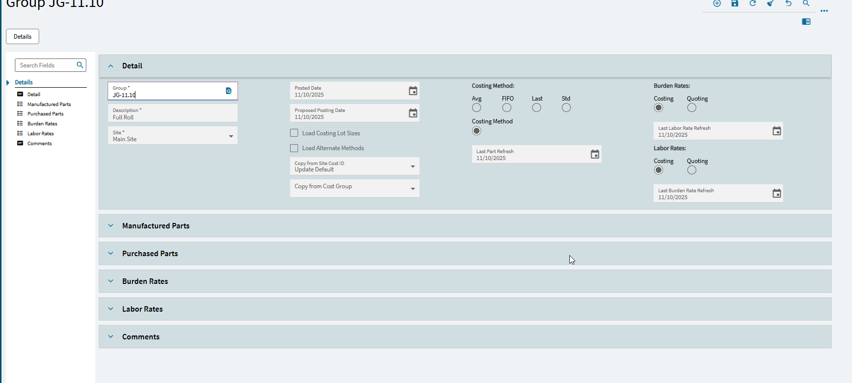

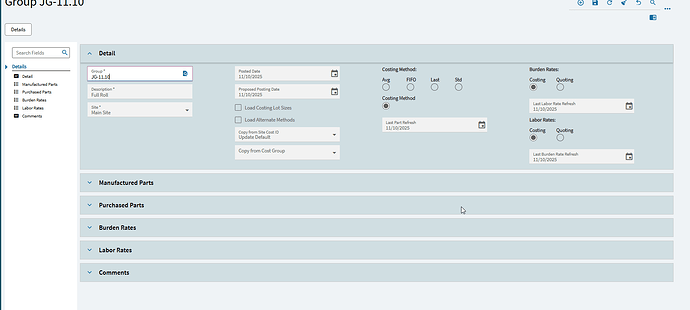

We are preparing for Go Live and practicing imports. We had a hiccup with Bill of Materials not having the UoM and some were off. As I fix them, we run a Cost workbench and roll up parts. This morning a user ran the costing workbench without selecting the costing method and ran it on all manufactured parts. We use Standard costing, and I had DMT’ed in the Standard costs through the Cost Adjust DMT. Some costs were set to zero as a result of the Costing Workbench being run without selecting the costing method.
We have test re-run the costing workbench with selecting the costing method and it seems fine, just wondering what went wrong that it reset the values.
Settings used that zeroed out the costs.
