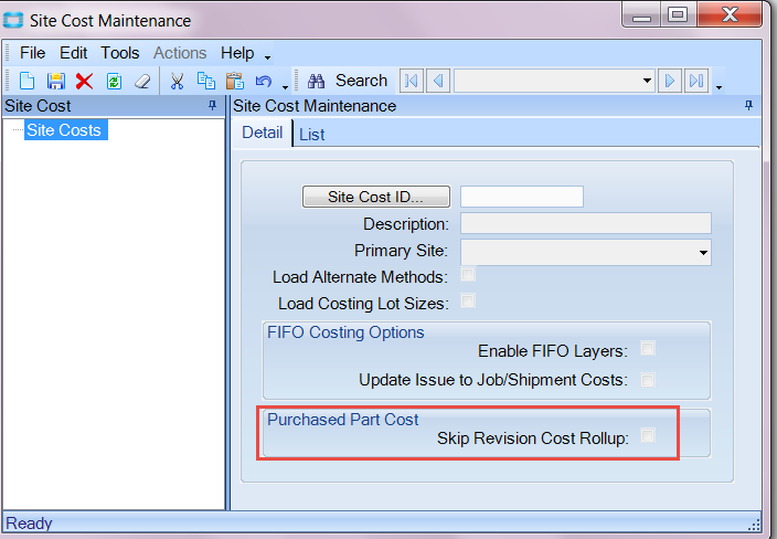

In addition to what Joe mention about “Enable MFG Cost elements”, Under Engineering Setup, there is a menu for “Site Cost Maintenance”.
When using Costing workbench, the system rolls up material, labor, burden, subcontract costs even if the part is coded as “Purchase Part” but if it has a method. In order to prevent purchase parts from rolling up as mfg part, you would need to check to box “Skip Revision Cost Rollup” under Site Cost maintenance.
We had issues when i cost rolled before where some of our purchase part had labor/burden costs on them after a cost roll. Finally figured out Epicor does not care if it’s coded purchase. if the part have a method, it rolls it up. I notice this feature in E10 to prevent purchase parts from rolling up.
Yeah, we already went through finding the issues of “enable MFG cost elements” and the “Skip Revision Cost Rollup”. It was messing up the Method tracker view costs well before I tried to get into the costing workbench. That was a long and frustrating support call until someone finally pointed me to that check box and it fixed what I wanted fixed.
