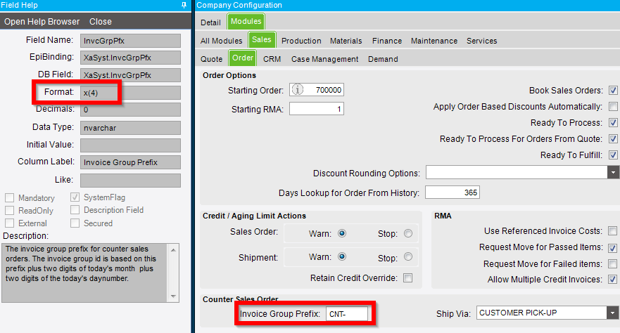

It appears Epicor made an undocumented change between 10.2.300.7 and .12 where the Counter Sales AR Invoice Group Prefix has been reduced from x(4) to x(2) characters. We had ‘CNT-’ and changed it to ‘C-’, and counter sales now work.
Hopefully this helps someone else. Our EpiCare Analyst figured this out, and is making a KB article to help the support team as well.
Note - Field Help states 4 characters, the dot release upgrade process did not flag this during the conversion, and nothing was mentioned in the release notes pdf. The warning message didn’t help, and this wasted dozens of hours across 5 peoples time to troubleshoot and work around. I can say for sure that we’re not going to treat upgrading dot releases without doing full CRP testing again…

Did they end up backing out the undocumented change? XaSyst.InvcGrpPfx still claims to be 4 characters in 2021.2.5.
Try setting a 4 digit prefix and doing a counter sale. If it doesn’t error, then they fixed it! :crazy_face:
Designing around observable behavior instead of documented behavior is always risky. Even if it appears to work, I’d feel safer knowing Epicor acknowledged that the change was a mistake. I can probably just convince everyone to just use a 2-character prefix…
