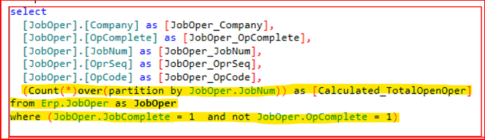

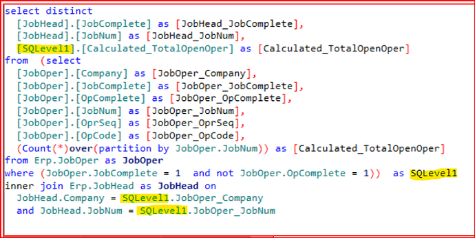

This might help!?
Count(*)over(partition by JobOper.JobNum)
Above statement will show count for all the operations which are open but job is marked completed.
And if you want to show results as in a single row, you might need to make a subquery out of it which would look like this:

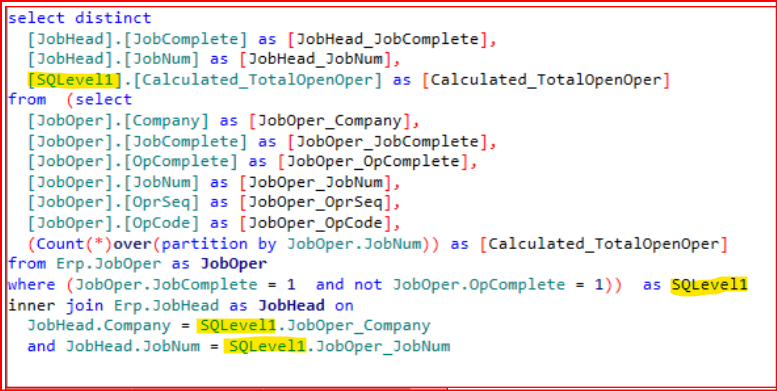

Oops…the following highlighted items are confusing me -
Is SQLevel1 representing the Subquery?
Yes, it is name of SubQuery
Could you explain the following (highlighted in yellow):
I’m not familiar with the count(*)over(partition…and what it is doing.

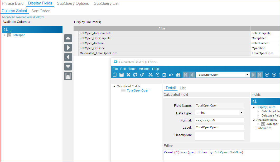

I’m using the BAQ Designer so that might be why I’m confused :thinking:
Count statement is a window function in SQL that counts the number of rows in a result set within specific partitions.
For eg: if you have a job which has 10 operations out of which 7 are open, it will show 7 as a result. Hence counting the open operations.

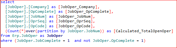

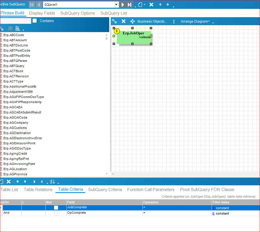

Yeah! if you are looking at the open jobs then probably set the table criteria as JobOper.JobComplete = 0. I amended that in snapshot below.
I am also using BAQ designer, it’s just I placed snapshot of QueryPhrase.

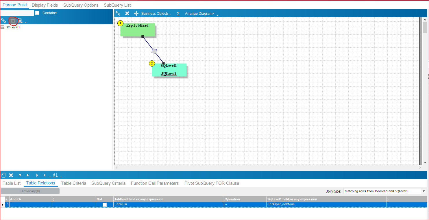

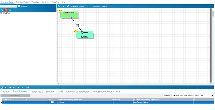

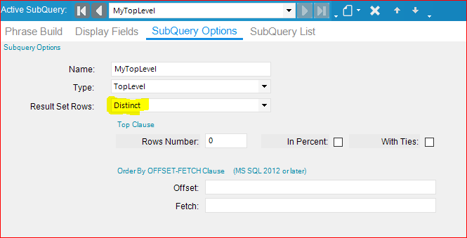

But here is the breakdown:
SubQuery:
Add a TopLevel query: Mark it as distinct.
Bring JobHead table and join the subquery:
This should help.
