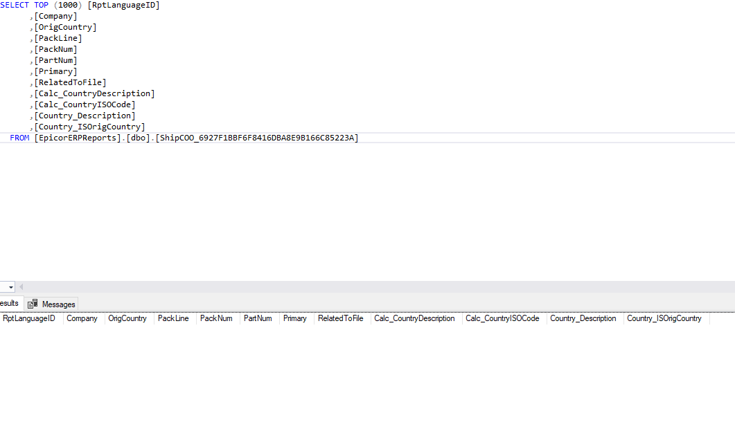

Sometimes I have found it useful to go to SQL studio and make the query in there, with the guid typed in, and check what data it pulls while messing with the SQL. Do you have access/ability to do that?

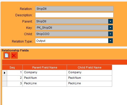

Hi, in Report Data Definition I have added country and created a relation ship between part and country. And then updated the report query.
What relationship did you use for your Part & Country? in the RDD file?
