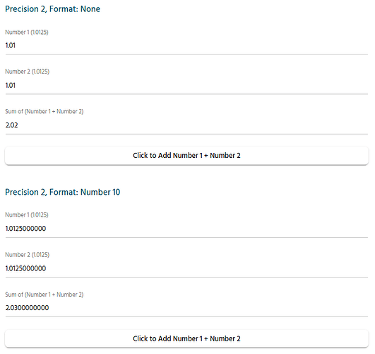

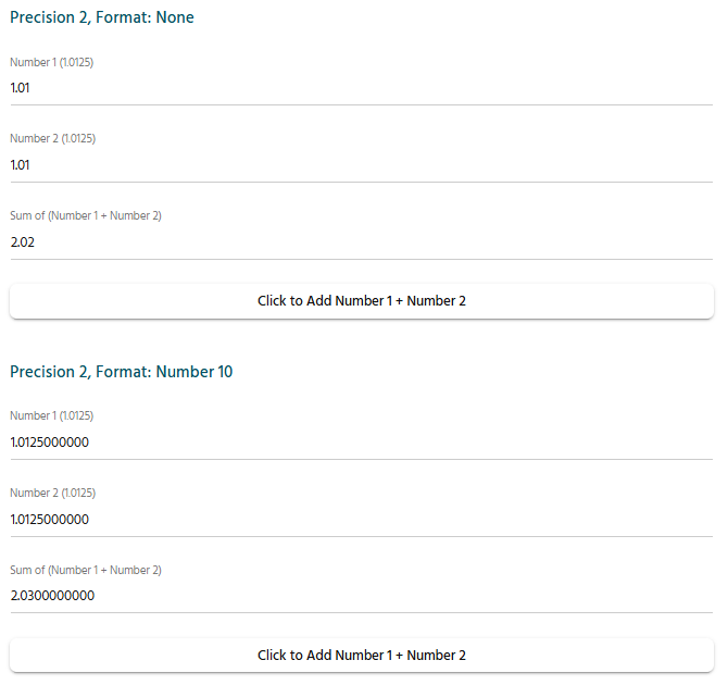

In the following example, I created 2 groups with 3 fields and a button where the only difference is the format of none vs 10.
1.0125 was entered as the starting value, but the results /format/ based on the options selected during setup.

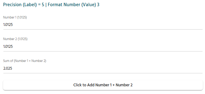

In the next example, I entered 1.0125 with the precision (label) set to 5 and the format number (value) set to 3.
We end up with a total of 2.025 and this makes sense because we are telling CPQ that we want to see up to 5 digits after the decimal.
(Remember that even if the number precision is set to 10, we would still only see 2.025, not 2.0250000000 – if that is the value we need, we would use the format precision instead)

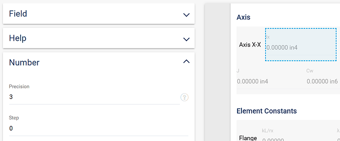

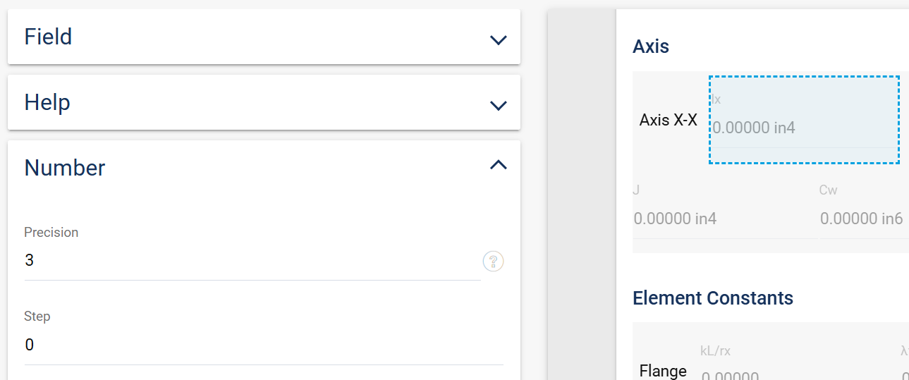

So now that I start to swap the fields I am noticing that under Number-Precision 3 and Format Prevision 5, it is displaying 5 decimals?
Second photo …

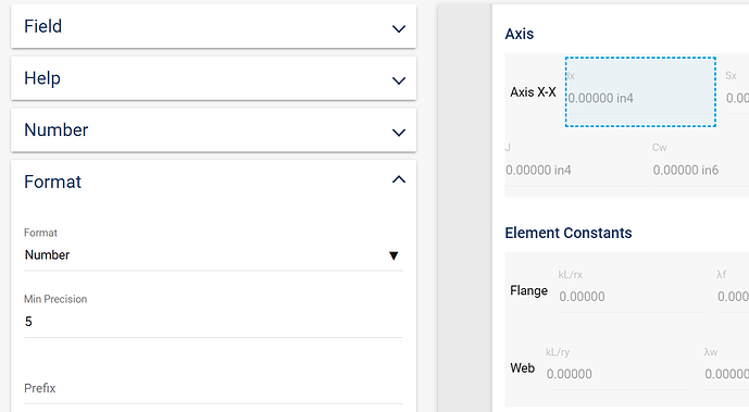

Hi Bill,
*** UPDATED ***
For now, I’ll simply recommend verifying that the appropriate number of significant figures are present and then leaving the values be or disabling format altogether.
In general, having the number precision be larger than the format precision should get you what you want.

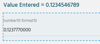

The longer I play around with this, the more I notice–here is another weird one:
How it landed on that value, I’ll likely never know.
(probably something related to how it determines what to calculate vs display–I did spend a few minutes trying out different variants.)

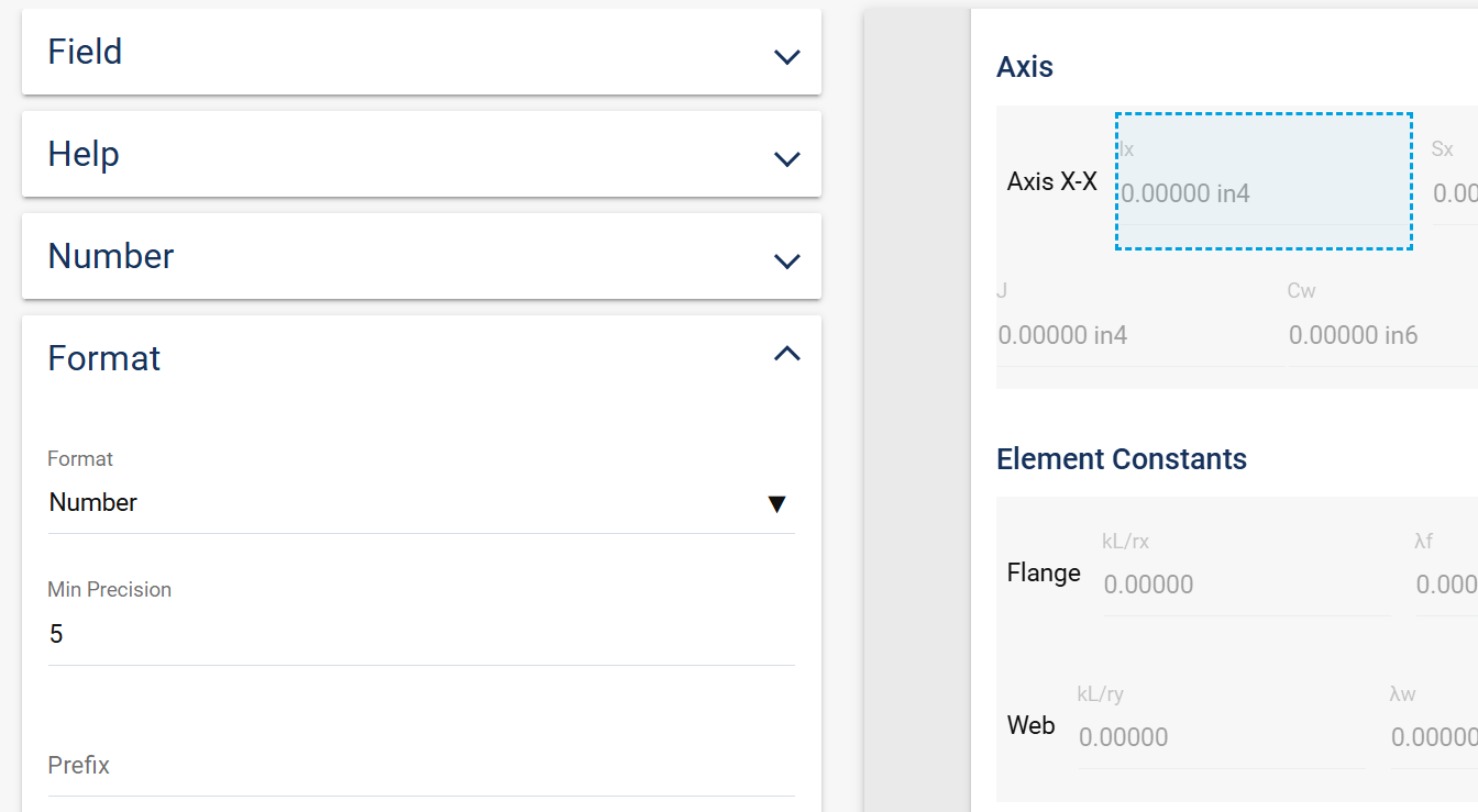

Number - precision is the number of decimal places that the value of the field will have.
Format - number - Min Precision is the minimum number of decimals that the field will display in the UI. This is just about controlling the format/display of the number.
If my number - precision is 10 and my Format - Min Precision is 2, a value like .1234567891 will show all 10 decimals places because the format wants to show a minimum of 2 decimal places. If my number - precision is 3 and my Format - Min Precision is 6, the value will only go to 3 decimals but when it displays the number in a field it will show 6 decimals.
