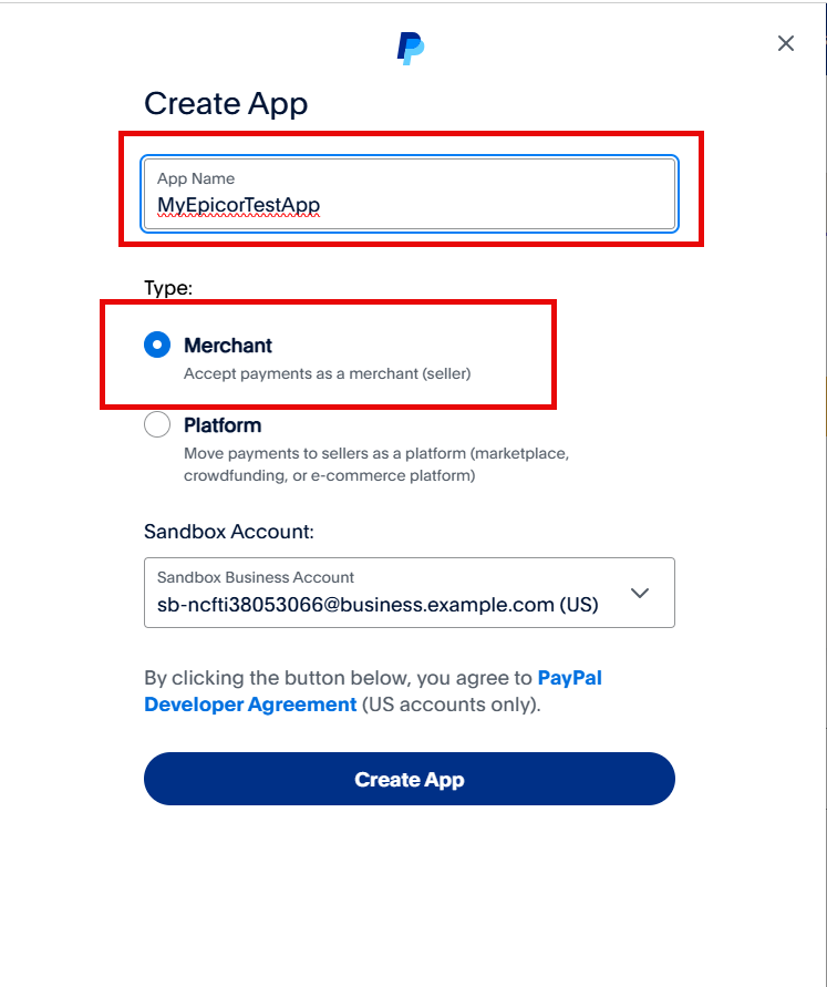

  3. Click Create App
  4. In the popup make sure you select Merchant and Give it an App name
  5. You will get a Client ID (Epicor Username) and a Secret (Epicor Password)

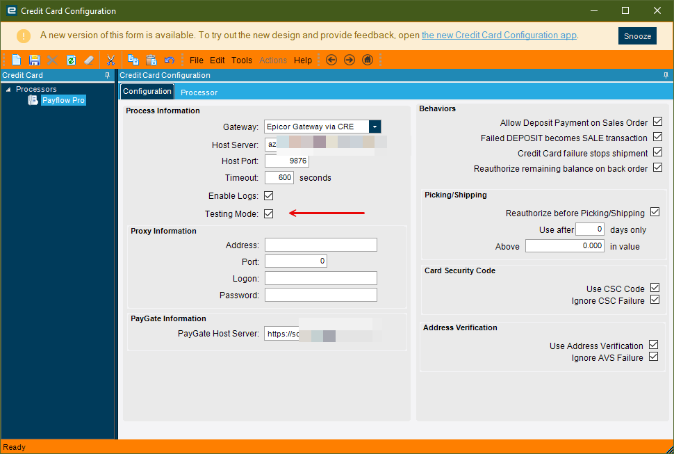

  9. In the Configuration Tab make sure you set Testing Mode
  10. In the Processor Tab you’ll want to Switch over to PayPal Testing and fill it out as shown below:

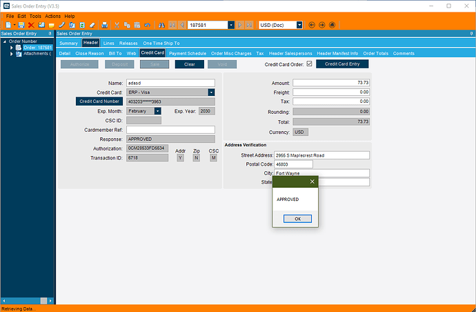

You can use the Credit Card Generator to Test your Setup in PayPal Developer Portal head over to Tools → Credit Card Generator
Go into Epicor and Process it through
