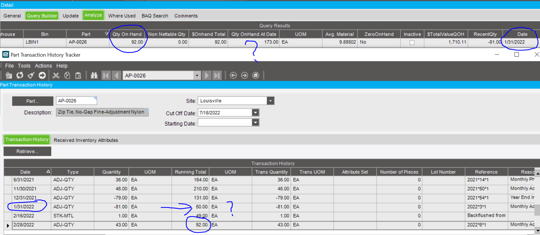

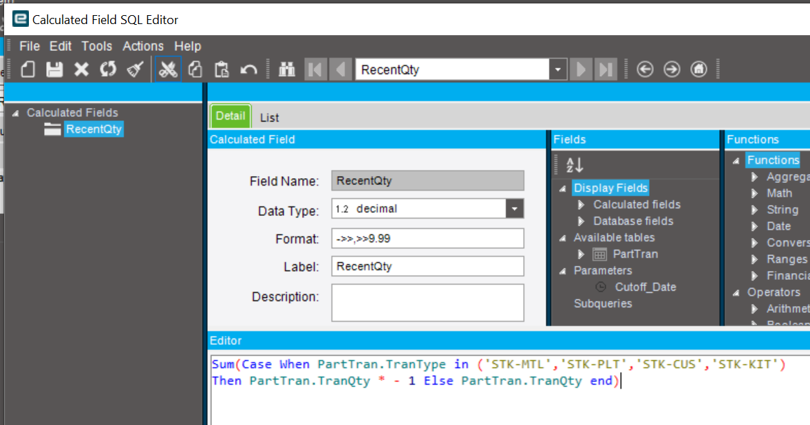

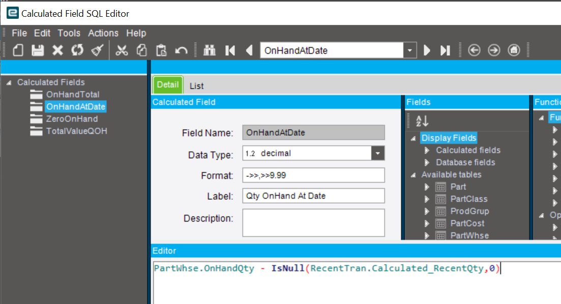

Having some issues with this BAQ/Dashboard. It imports fine and you have to create an additional BAQ for the WarehouseCode parameter. The issue is the quantity on hand at date calculation. It is not working correctly. Please see below screen shots for an example part AP-0026. Currently, we have 92 on hand which is correct as of today. However when you run the dashboard or BAQ and put in your Cutoff Date the Qty OnHand At Date does not work correctly. Could use some help in tweaking this formula - if that is indeed the problem.
Above, you can see the cutoff date I ran this for is 1/31. I should be showing 50 on hand total not 173 - no idea where it is getting that math from. 92 on hand is correct for current QOH, but I would expect the query to display 50 pieces on hand as of 1/31.
