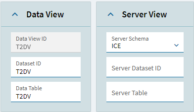

Just a general question to see if what I am doing will create any unforeseen issues. I am creating some dataviews that I only want in session, that is I do not need them to talk back to the server. I am setting them up like this and would appreciate some feedback.
Yup–that’s perfectly okay.
Strictly speaking, you don’t even need the Dataset ID and Data Table defined, but you won’t get intellisense without those.
In essence, the stuff in the Data View group contains properties that define the in-memory dataset handled by the application.
Setting up the stuff in the Server View maps the Data View properties to the DB Tables on the server.
