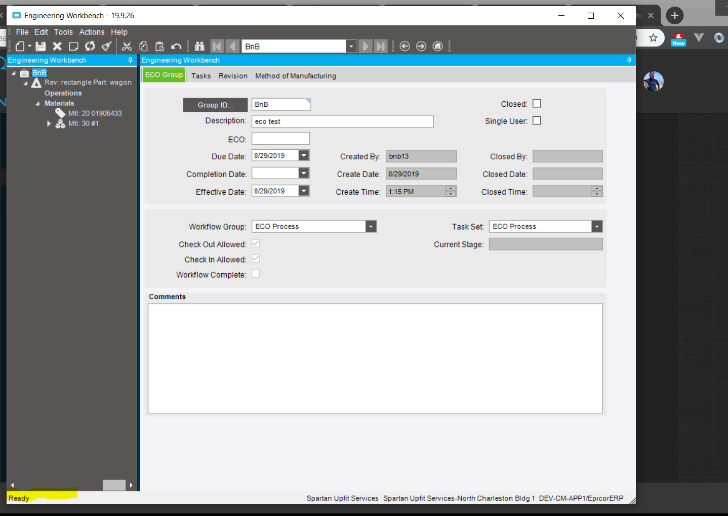

How can I log to this part of the screen within a customization. (want to show progress)
// Status Text: Ready
this.oTrans.PushStatusText("Cat.."); // Status Text: Cat...
this.oTrans.PushStatusText("Mouse.."); // Status Text: Mouse...
this.oTrans.PopStatus(); // Status Text: Cat...
this.oTrans.PopStatus(); // Status Text: Ready
Have anybody tried to push status text from BPM, please let me know
That is what I use.
