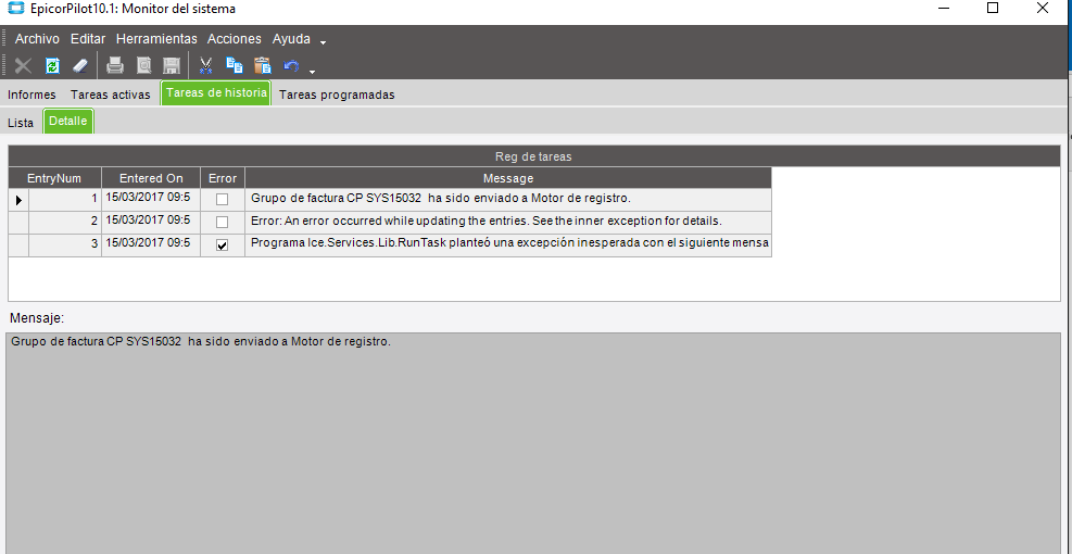

Alguien a usado en ingreso de factura de CxP el procesamiento de Crear Factura de Corrección CxP? estoy haciendo el proceso pero me esta generando un error a la hora de procesar el grupo.
No se va a revisión de diario pero me da un error en el monitor de epicor.
Puedes enviar la misma pantalla pero seleccionando el detalle de la última línea?
Línea 2
Error: An error occurred while updating the entries. See the inner exception for details.
Linea 3
Programa Ice.Services.Lib.RunTask planteó una excepción inesperada con el siguiente mensaje: RunTask: An error occurred while updating the entries. See the inner exception for details.
Stack Trace:
at Erp.Internal.PE.PEError.ProcessExceptionList(PostingStage peStage, Exception ex, Boolean suppressRethrow) in c:_Releases\ERP\UD10.1.400.21\Source\Server\Internal\Pe\PEData\PEError.cs:line 374
at Erp.Internal.PE.AP_INVOICE_01_Post_1052C024FEB09845ECB11D25A359B9A6B6.Post()
at Erp.Internal.PE.PEABT.Post() in c:_Releases\ERP\RL10.1.400.0\Source\Server\Internal\Pe\PEABT\PEABT.cs:line 269
at Erp.Internal.PE.AP_InvoicePre_Post.Post() in c:_Releases\ERP\UD10.1.400.21\Source\Server\Internal\Pe\AP_Invoice\AP_InvoicePre_Post.cs:line 1583
— End of stack trace from previous location where exception was thrown —
at System.Runtime.ExceptionServices.ExceptionDispatchInfo.Throw()
at Erp.Internal.PE.Pre_PostBase._RunProcess(Int64 instance_TaskNum, String groupID, PostingMode mode, Boolean skipPEDataInit) in c:_Releases\ERP\RL10.1.400.0\Source\Server\Internal\Pe\Pre_PostBase\Pre_PostBase.cs:line 191
at Erp.Internal.PE.AP_InvoicePre_Post.Pre_Post(Int64 instance_TaskNum, String groupID, PostingMode mode) in c:_Releases\ERP\UD10.1.400.21\Source\Server\Internal\Pe\AP_Invoice\AP_InvoicePre_Post.cs:line 281 at Ice.Hosting.TaskCaller.InnerExecuteTask(IceDataContext newContext) in c:_Releases\ICE\3.1.400.21\Source\Framework\Epicor.Ice\Hosting\TaskCaller\TaskCaller.cs:line 95
at Ice.Hosting.TaskCaller.ExecuteTask(Boolean suppressTransaction) in c:_Releases\ICE\3.1.400.21\Source\Framework\Epicor.Ice\Hosting\TaskCaller\TaskCaller.cs:line 31
at Ice.Lib.RunTask.BpmFriendlyTaskLauncher.Run(String sessionIdPrefix, IceContext db, Action taskRunner) in c:_Releases\ICE\3.1.400.21\Source\Server\Services\Lib\RunTask\BpmFriendlyTaskLauncher.cs:line 63
at Ice.Services.Lib.RunTaskSvc.InnerRunTask(Int64 ipTaskNum, Boolean suppressTransaction) in c:_Releases\ICE\3.1.400.21\Source\Server\Services\Lib\RunTask\RunTask.cs:line 502
Excepción interna:
Stack Trace:
at System.Data.Mapping.Update.Internal.UpdateTranslator.Update(IEntityStateManager stateManager, IEntityAdapter adapter)
Hola Andres,
El log que colocas no esta completo … si puede revisa los archivos de los
logs del servidor para verificar si esta todo el mensaje de error.
A mi parecer… el sistema esta intentando ingresar un registro en una tabla
que ya existe en la base de datos.
