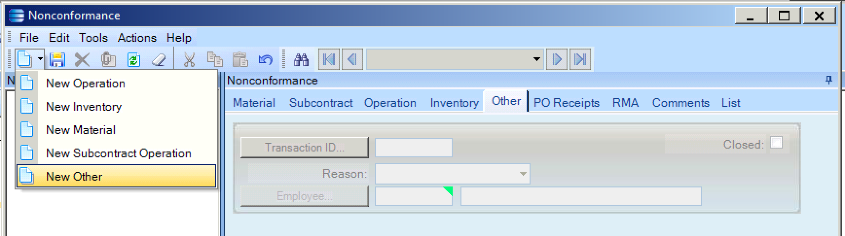

I just checked one of my last E9 Clients and I can confirm that you must at least have a Nonconformance record to create a Corrective Action. Whenever I’ve had a client that needed to create a Corrective Action without a Nonconformance I advised them to create an ‘Other’ Nonconformance with the Issue that needs a Corrective Action in the Comments (Comments tab) and then check the ‘Closed’ checkbox.

Well, if you can’t get them comfortable with creating a ‘Other’ Nonconformance, you could always customize CA Entry or use BPMs to use a BPM Form when they attempt to create a CA without a NC and prompt for the Nonconformance comments and then create the NC in the background and populate the CA’s NC field with the new NC?
