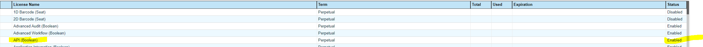

Can I just ask what License do you need for this to work?
Not sure but I would guess this one?
