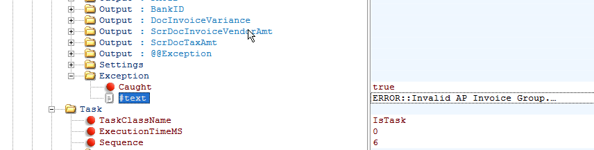

Could you provide a screenshot of the error in question? This sounds like new behaviour which shouldn’t be happening… The only GroupID related issues I have ran into is if a user is in the group so it is locked or if the GroupID name isn’t valid, according to Epicor requirements.

Depending on where in the workflow this is happening and how that BPM is interacting with the same table, it is likely a valid error in that the GroupID does not exist. My assumption is that if you were to manually create that GroupID in Epicor and then clicked submit in ECM, that it would process just fine.
Well, yeah. That was my original question. It’s really easy to delete an invoice group, so I want ECM to create the group if it doesn’t exist. My test is that I deleted the group to see if it would create it (like you guys said it would). It works fine if the group exists.

I’ve found a sleep task could help with the exception that occurs when the group is locked, it will recheck when the group is unlocked, then if the group already exists and is locked / in process of posting, will recreate the same group again.
I didn’t think of the sleep task! That’s a good idea. We’ve had invoices created, but it’s the attachment that didn’t work. Clicked submit on the exception and it went through. If I add the sleep task, the automatic retry is even better. Love it.
