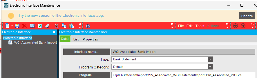

  1. You Clone StatementImportCSV_Example and name it StatementImportCSV_BankOfAmerica_XYZ
    1.1 Then you change the files inside as well, and all classes that say StatementImportCSV_Example to StatementImportCSV_BankOfAmerica_XYZ
  2. Now in Epicor you create a new Electronic Interface via Electronic Interface Maintenance
  3. Now you will be able to assign it in Bank Account Maintenance under the Bank Reconcilation Tab
  4. Now when you run Bank Statement Import it will use this .cs

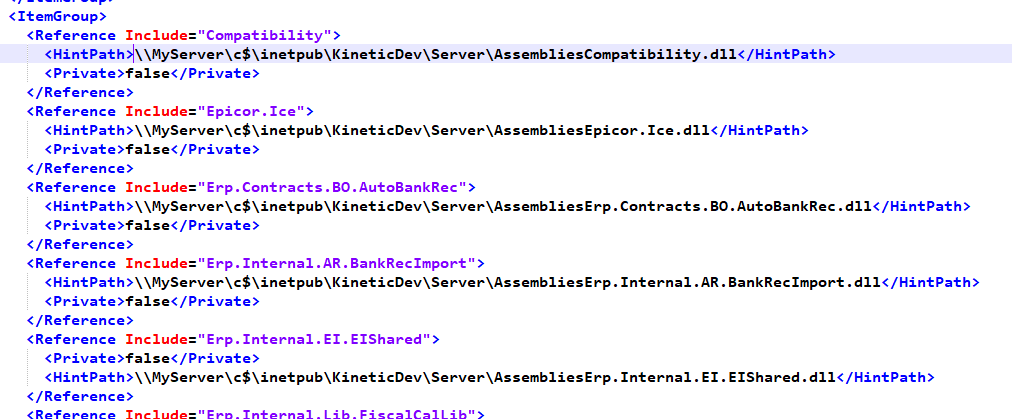

All the other methods are up to your discretion. However you should be able to just modify them, and whatever opStatementHeaderList gets assigned to is what Epicor will feed the UI (Client).
The StatementHeader is an Epicor Custom Class that it expects in return, it holds the Header and StatementLines that the Client expects to read, whatever you set in that object in the EI, it will read. The more you specify the better the matching. Once you get auto-complete set you will be able to step into and see the values, otherwise use reflection its in Erp.Internal.Lib.StatementImport
<Reference Include="Erp.Internal.Lib.StatementImport">
<HintPath>..\..\..\..\..\Deployment\Server\Assemblies\Erp.Internal.Lib.StatementImport.dll</HintPath>
  <Private>false</Private>
</Reference>

Epicor has some helpers, you can modify the .csproj and .sln to point to your Servers Assemblies, and then when you run the folder in Visual Studio or VS Code, you will get auto-complete.

EI Name EI Program EI Type
Our Bank Import Erp\EI\StatementImportCSV_OurBank_WCI\StatementImportCSV_OurBank_WCI.cs Bank Statement

  • Launch Bank Account Maintenance and Navigate to the Bank Reconciliation Tab
  • Configure the Electronic Interface for XYZ
  • Validate that it works by importing an example CSV
