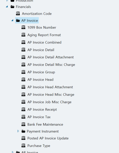

Looking at the AP menus in DMT, the menus are subdivided into AP Invoice Group, Head, and Detail. So, in order to complete the AP Invoice, I think I need to generate each of these DMTs…
Is there any way to generate them all at once?

Haven’t done AP but suggest check out the AP Combined template. These typically do two or more tables at once. Prolly does all three in this case.

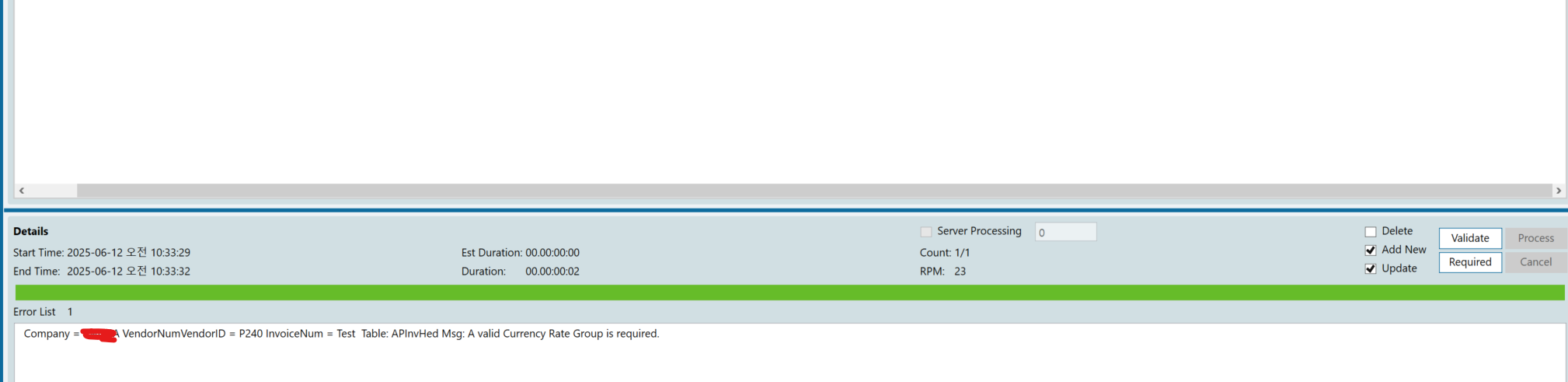

Thank you. What error does this message refer to?
As I said I’ve not done AP DMT but it refers to a required currency rate. I’d suggest finding which field and what is expected value.
