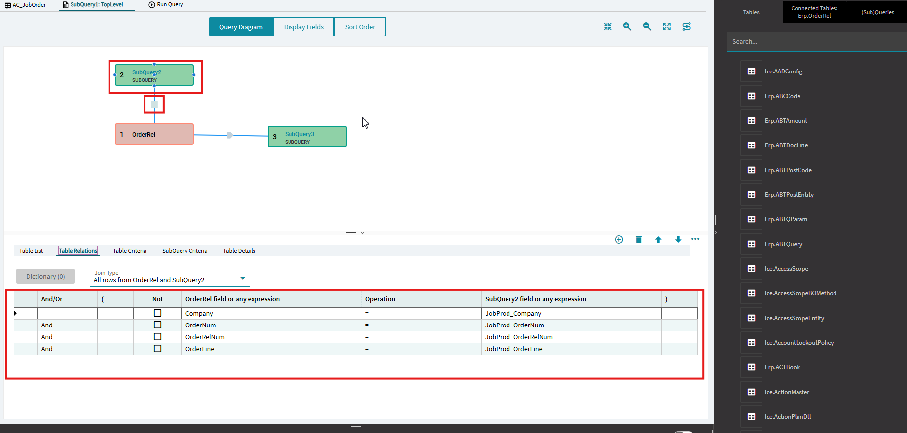

Join between subquery with job info and order rel info attached (subquery 3 is just order hed and customer info so it doesn’t technically have to be a subquery but it just seemed cleaner that way)

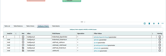

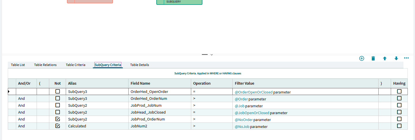

So after that was working here are the subquery criteria I made:
Each of these subquery criteria is either set to be greater than 0 or equal to a boolean value. These allow me to filter in order: Filter open or closed orders, get all orders regardless of if it has a job or not, get all jobs regardless if it has an order or not, filter open or closed jobs, filter out rows without orders, and finally filter out rows without jobs. For the last one I used a calculated field that uses nonull since the results of the jobprod_jobNum field has some null values. Seemed easier than dealing with nulls, but I am sure there is a way around that without using calculated fields but I have a job to do and this works so moving on.

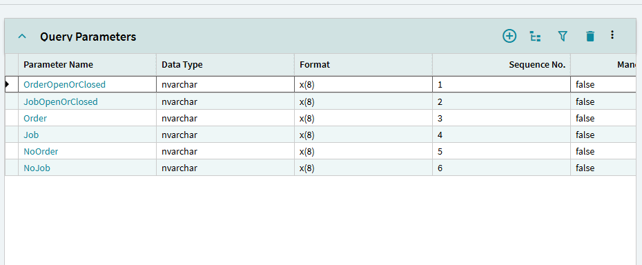

Next I set the query parameters as the lads suggested, thanks again:
setting them all to char just seemed to work, but I think there is a way to use the correct data type just not sure how.

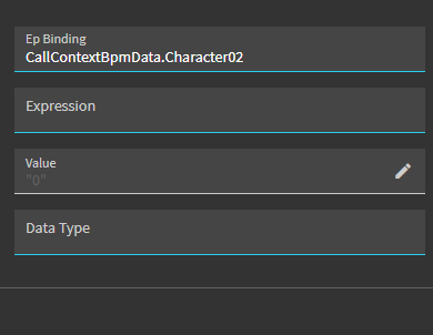

On the app studio side I ended up using callcontextBPMData.Character02 and checkbox01 for the 0 value and true false values respectively. character01 is being used by my dropdown currently.

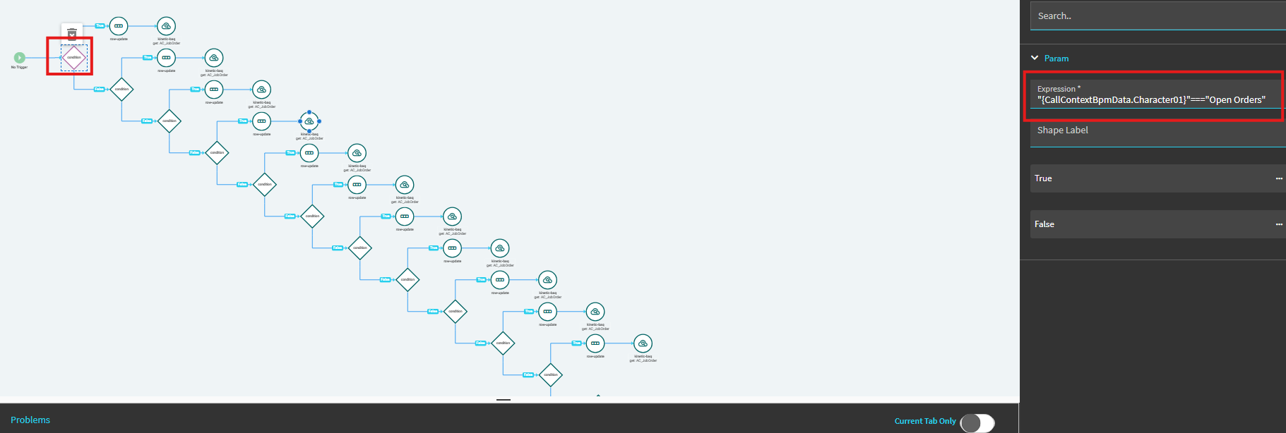

I then created a data event that fires whenever callcontextBPMData.Character01 is updated (my dropdown) and ran this event to then decide which filter I am going to use:
Each condition is checking for a different value for the dropdown (If anyone knows how to use case instead of condition, please let me know I can’t get it to work for the life of me lol) this works just fine, probably very slow programmatically but I don’t have too much else going on so it should be ok.

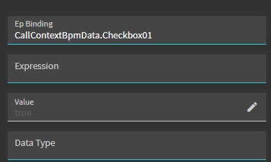

On True I update the checkbox and character 02 fields"
only reason I call it each time instead of setting it at the beginning is because if I want the checkbox values to be different depending on which condition is true. I know I can find a way to set some of the rows before the condition check fires, but this works and I am not doing it again so moving on

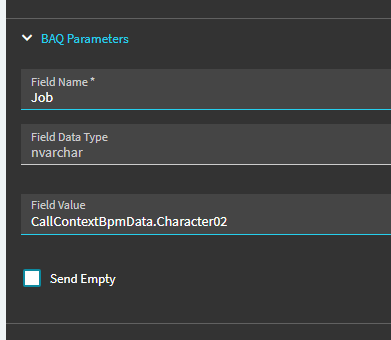

I then create a BAQ event that grabs my BAQ, and go into the parameters as suggested and enter the rows I just updated prior:
(Note) I do set each parameter to be ignored if empty so I can have multiple, but if you want to force an entry all the time you would set that on the BAQ query parameters section.

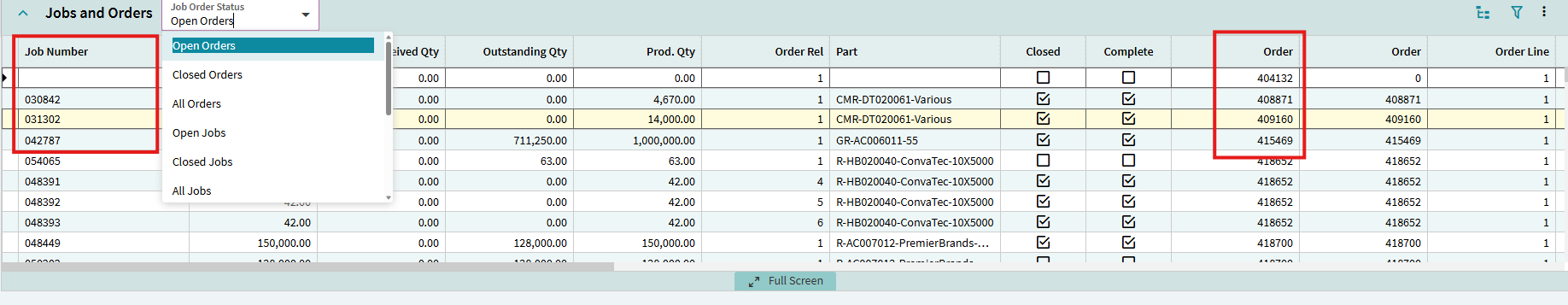

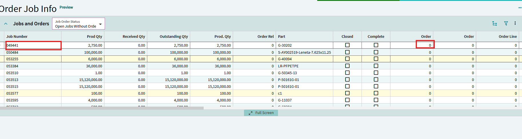

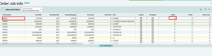

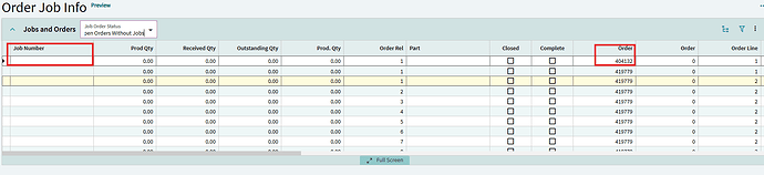

Then after all that it just works! Final Product:
Production will now be very happy that they can filter open and closed stock jobs, and find which orders dont have jobs processed yet by the CSRs. Hope this helps with other peoples projects!
