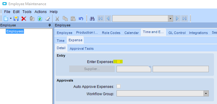

This setting works in tandem with the Enter Expenses checkbox in emp maint in the screenshot below. When you check the Enter Expenses checkbox in emp maint then save the record, it will automatically create and link a supplier to the emp record with the prefix defined in comp config.

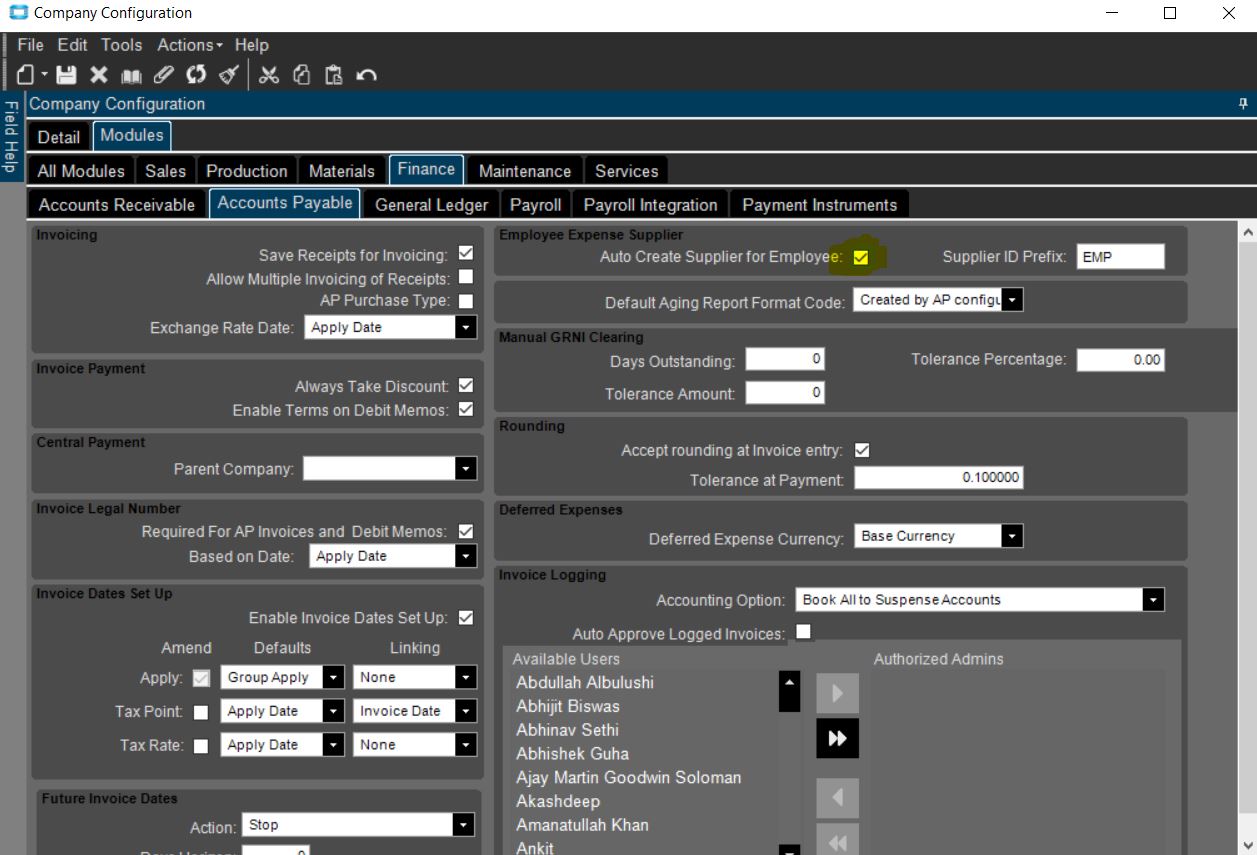

There is a setting on Company Configuration under AP where you can specify a prefix and a supplier is created when you create an employee with the prefix.

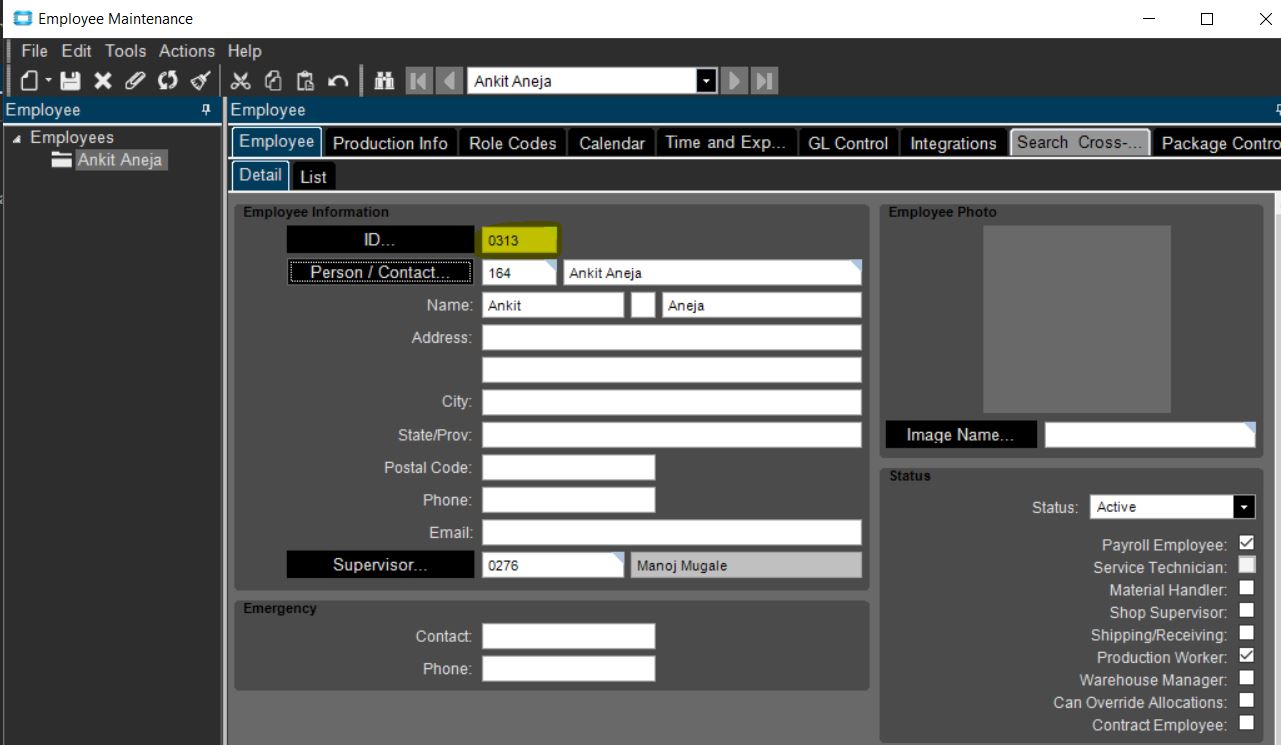

Dear Vinay, We have already set the Prefix at Company level. But problem is that how to add EmpNum with prefix. By default system is generating auto sequence refer to below attached screen shots
Please suggest how to create Employee Supplier Id like EMP0313 (Prefix-EMP , Sequence- EmployeeID) instead of EMP21?
