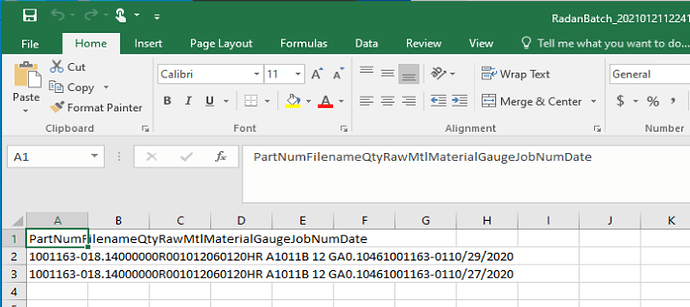

But my output looks like this:
What’s the secret sauce for getting the tab character inserted?

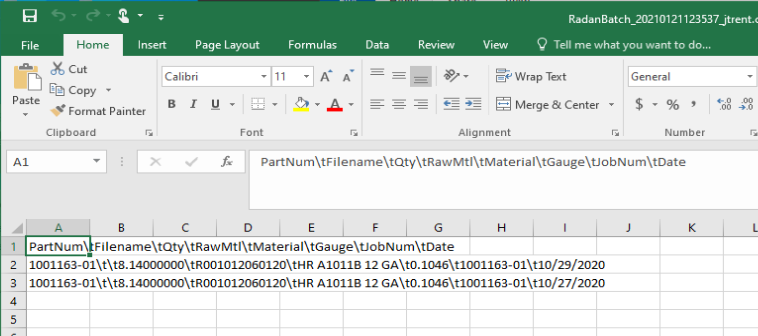

Changing to:
string tab = @"\t";
Resulted in:
Tricky Ol’ backslash vs forward
Doug,
Here’s what I’m getting:
I haven’t tried manually creating the strings yet.
Joe

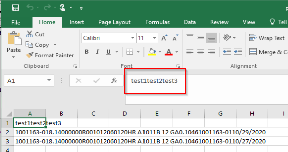

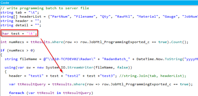

I tried this:
And got this:
Wondering if StreamWriter is filtering them out.
Thanks for your help.
Joe

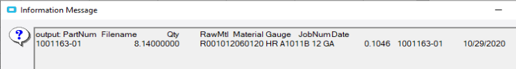

Here’s the data we’re writing out. It looks like the tabs are in there okay.
I don’t know if the NewLine is causing any issues.
