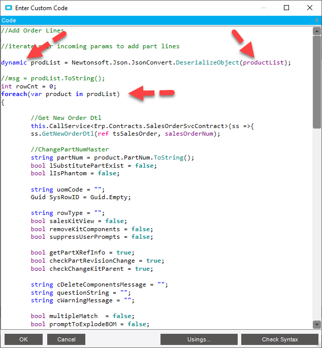

Just use the var keyword and then deserialize your JSON string from there :slight_smile:

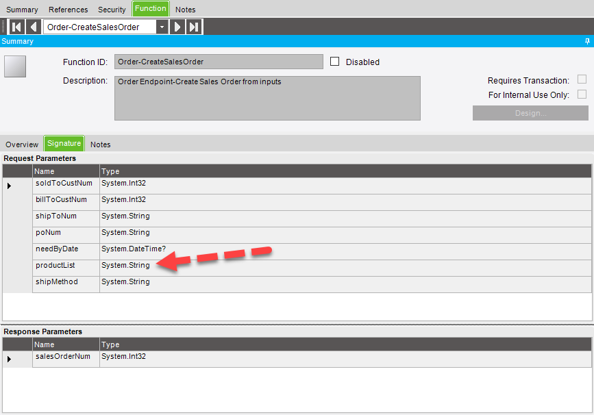

Function Signature:

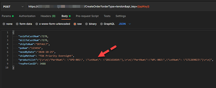

Calling the Function:

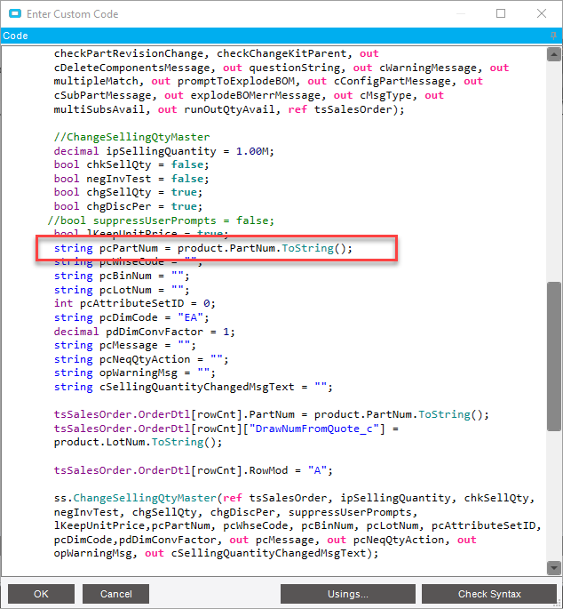

Consume the json string (with the use of a local dynamic variable):
Access by key
