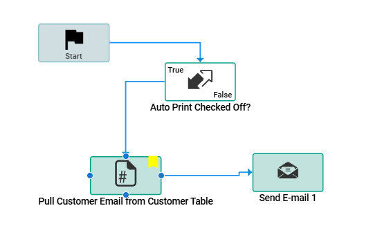

Hi Everyone,
I’m relatively new to BPM creation and have been tasked with creating a BPM which automatically emails out a Sales Order Acknowledgement when Auto Print Ready is checked off. I have the workflow below working for the email generation on SalesOrder.MasterUpdate but I have no clue where to even start with generating the SO and attaching it to an email. I don’t have a background in coding so I’m a bit limited in what I’m able to accomplish on my own or by repurposing other peoples work. I’m just at a complete loss.
Any help at all where to start or what I could try is greatly appreciated.
If you’re in a data directive look at the Auto Print function.
Do you have Advanced Print Routing (APR)? That’s going to decide if you can do it the easy way or the hard way.
Hi Kevin,
No we don’t currently so I think I’m stuck doing it the hard way.
Did some research and spent some time with Epicor talking through this problem and we were able to come up with the below which seems to work. Still needs testing to make sure there’s no weird behavior but thought I’d share the code for anyone else with a similar issue. Adapted from here: Send an Email containing output of an SSRS template using Data Directive - #13 by Shizar115
