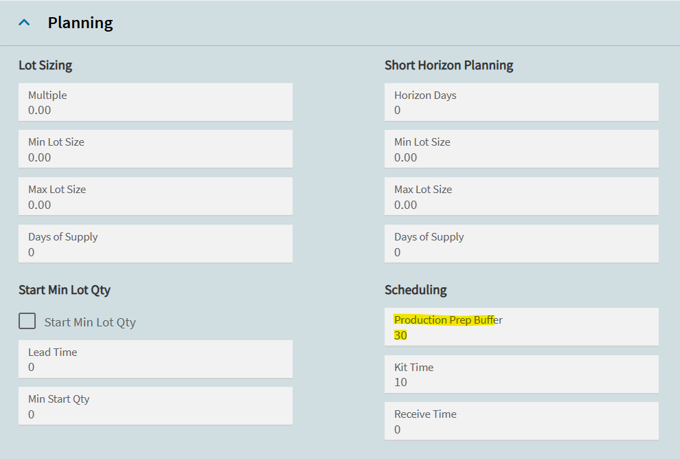

Off the back of a topic I raised about creating a customisation that would populate a field on Job Entry, using criteria from a field in PartPlant, this is now working great for us.
Using a data directive on JobHead, bringing in an Update Table by query, joining in Part Plant and setting the calculation on the JobHead.BufferDate_c we created.
ttJobHeadRow.PlannedKitDate?.AddDays(-queryRow.PartPlant_PrepTime)
However… we now need to make this look at working days (Mon-Fri) rather than calendar days. As far as I can tell, there’s no way to add a function to the same expression as it errors saying ‘Expression should contain only one statement’.
Does anyone know any ways we could create a WorkDays function that sits in front of this Update Table by query block or do we maybe need to rethink this whole method? :thinking:

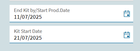

Thanks Cory!! It’s not quite using the weekend exclusion yet, (Prep Time = 10 days) yet
but it accepted the Syntax so gives a base to work off, thanks so much :slight_smile:

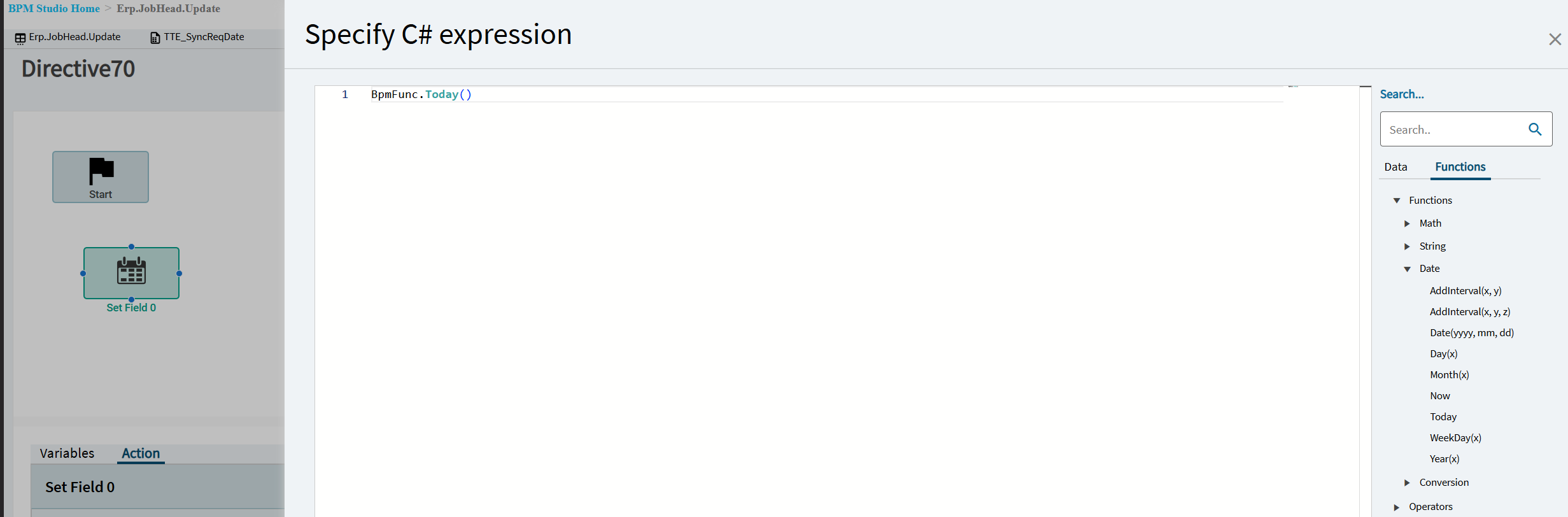

I’m just thinking if we need to switch this to a pre-processing method to give us more functionality, maybe using the ‘Invoke Function’ to work out weekdays before we set the ‘Update Table by Query’ :thinking: do you know how we might be able to use this please?
I’ve checked in Dev tools/debugger and it doesn’t need to be a data directive, we are only to looking to update JobHead.BufferDate_c based on if the JobHead.PlannedKitDate has been changed.
