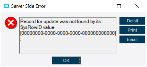

Any ideas? I have followed the trace!
What does the Error Detail say? What do you see in the server event log?
Write your own trace logs so you can see where in your code it is failing
I have resolved it now. It was due to having an additional RowMod above another RowMod. Stupid me! Thanks for all of your help ![]()
