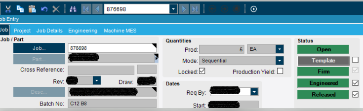

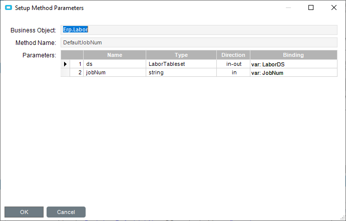

Constantly getting A valid Job Number is required
I have checked the JobNum and it’s valid.
Here is the BPM. I am using Method GetNewLaborDtlNoHdr
Still same issue :confused:
Is the job open? Is it released? Is it completed already?
Everything seems good.

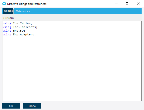

Geez! that’s a lot of widgets… Sometimes those widgets just get in the way, IMO I’d move this to a custom code block you get more control that way.
Custom Code he says. You’ll have more control.
It’s writing the custom code block… I have no clue.
Check this thread out,
Get started down that path and come back if you get stuck
Do you know what adapters I need to use?
I have added Labor and LaborDtl
no Adapters this is server side.
The link I gave you that points to my example is for Server Side (BPM) no adapters needed.

laborBO.DefaultOprSeq(ref lds,opSeq, out msg);
What is msg
