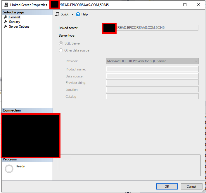

Hey Jamie!
Should be able to use the following settings if you are on SaaS
Linked Server = Your Read Only Server Name (12345read.epicorsaas.com,portnumber)
Server Type = SQL Server

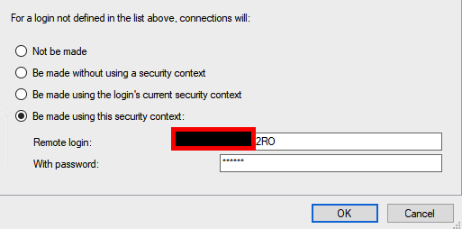

Security → “Be Made Using this Security Context”
Your Read Only user name and password
You should then see your databases in the linked server, and be able to query them.
Hope this helps!

Thank-you that appears to have worked for me.
