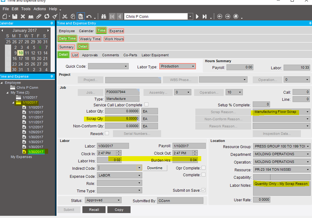

Here is a T&E result from a test I just did (1/30, note the payroll date is 1/10 and makes it weird to view in T&E)
The payroll date should be based on the date of that the user clocked into the system, not the date that the user clocked into the job. So if you clocked completely out of MES, then clocked in under today’s date and entered more scrap, it would show the payroll date as today.
I do see that it seems to be capturing Labor and Burden hours. It is splitting the labor, but not the burden. Interesting. Are you clocked into more than 1 job?

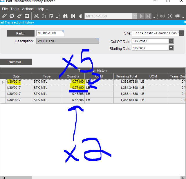

On a side note, I verified my backflush is working properly off of those scrap transactions! Woohoo!

<clarification - on that date I was logged into 2 jobs>
I was only clocked into 1 job BUT, the process of reporting scrap logged me against the existing labor header. I am not actually STARTING ACTIVITY, like I do on my Job Queue mod so it doesn’t appear in the queue (even if it did, it immediately logs out once posted). I couldn’t log into the job twice (as in Start Activity), which makes sense - good job Epicor.

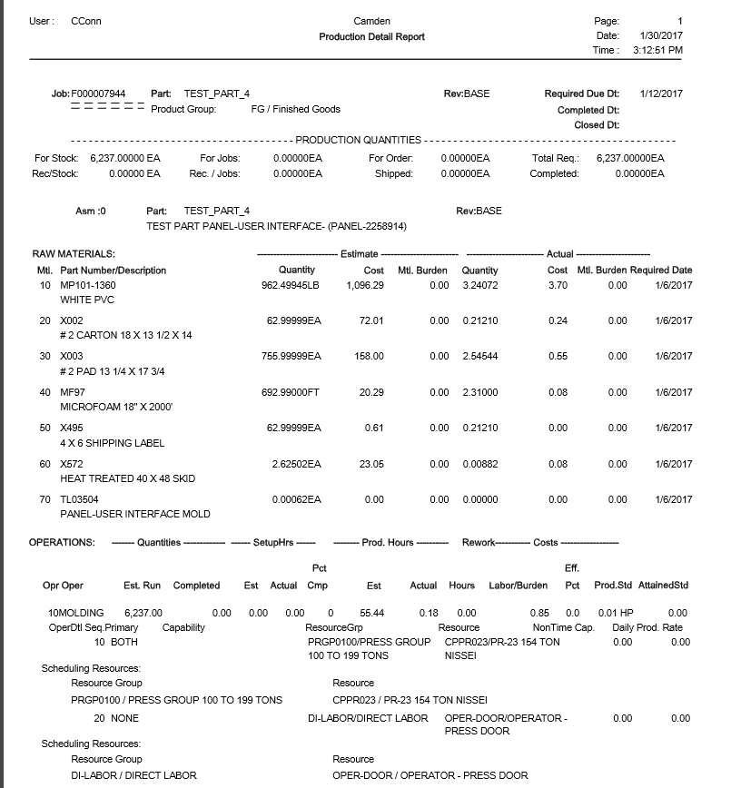

I’m just curious what this did to the labor dollars though. I’m wondering if it split the dollars behind the scene. Run a Production Detail and take a look to see if the labor dollars are 1/2 of what they should be. We will have to look at how it “costed” out the scrap.
Just saw your edit…that is why the labor is split! Did you say you ran the test again after “clocking out” and back in??

Latest Test (logged out, back in - then logged out of job end activity, THEN reported scrap
Interesting. It looks like there is labor cost and material cost but no burden cost. Material cost looks accurate. I’m looking at the operations and the resources. I’m not sure how it is getting .85 since you have no rates set up for either resource. I should say, no rates that I can see in the production detail report. Do you have a labor rate set up on your employee record? There has to be something driving it to get .85 worth of labor.
You would want the labor rate for parts, but you would also want the burden rate. Is there a burden rate set up for the machine that you used?
There is a labor rate against my employee ID and also one for the Resources (machine press). It’s not apparent to me yet where the value of 0.85 is coming from.
<edit>Ok looks like its using the burden rate of the machine.

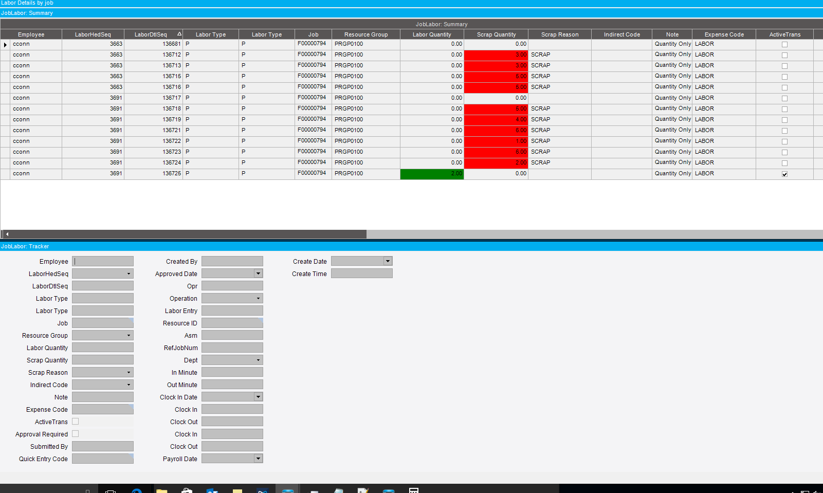

Here is a BAQ/Dashboard I made to view the labor against a specific job number:
The burden should be: 20.28 x .04 = .8112 and the labor should be 9.25 x .02 = .185
.8112 + .185 = .9962
I’m not sure why your labor is half of your burden. Do you have split burden checked on your resource group?
Yep, apparently so.
The cost of the scrap should stay in the job and not be cleared until the job is completed and closed - which it looks like this is happening on this job.
I would like to see what it does to labor and burden when more time goes by and scrap is reported. I’m thinking that it is only pulling in enough time on the scrap entry to do the transaction, not the actual/estimated amount of time it would take to complete those parts.
And that might not be a problem if you aren’t trying to analyze scrap cost from this entry. If so, you probably would want to do that cost calculation manually.
