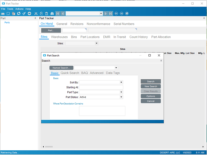

I’m sorry if my question comes across as confusing. I already have the option for them using a wildcard. The issue is, they want to be able to also search for a part if they do not know the part. So like a basic search with a little menu that pops down with the parts that start with what they searched. Essentially like the Part search thats in every other application within epicor. I just want to make sure I keep the ability to manually type in a part number with a star after it so it picks up multiple parts.
Oh you want like a search button on a dashboard.
So if the dashboard is set up with a tracker and a Dashboard Browse filter, the Search icon in the toolbar will load the relevant quick search screen:
You can customize that quick search screen if you need.

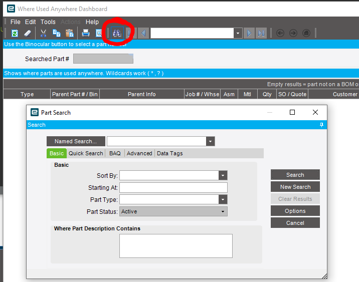

Terry, I think is this almost getting right where I want it. Now, is there a way that I can make a button like you said called “Search” and it brings up the part search, so users don’t have to click the binoculars button? Then, once they have a list of searched parts, the part they select auto fills in my tracker?

Do you agree then I should use Terry’s suggestion? Just need to know how to put that search functionality into a button then instead of the binoculars
Use a quick search a BAQ as your data filter.
You can customise the Quick Search to return data to your dataView on the Dashboard.

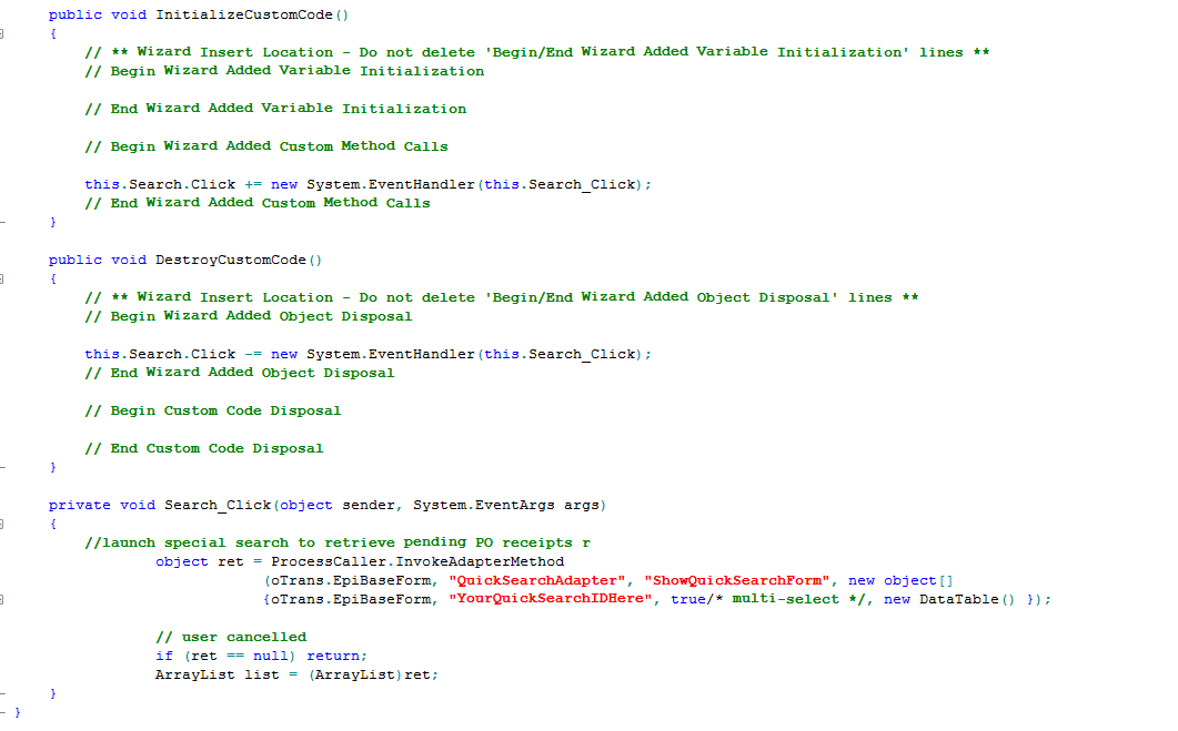

Here is the code to launch a Quick Search
//launch special search to retrieve pending PO receipts r
			object ret = ProcessCaller.InvokeAdapterMethod
						(oTrans.EpiBaseForm, "QuickSearchAdapter", "ShowQuickSearchForm", new object[]
						{oTrans.EpiBaseForm, "YourQuickSearchIDHere", true/* multi-select */, new DataTable() });
			// user cancelled
			if (ret == null) return;
			ArrayList list = (ArrayList)ret;
What is ‘oTrans’? It gives me an error that it doesn’t exist in the current context.

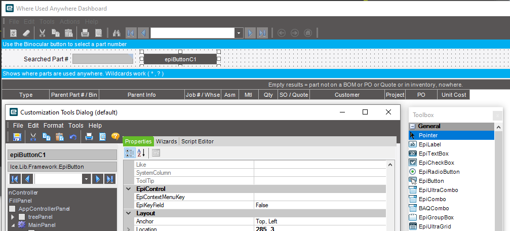

I’m in the dashboard editor editing the code for the button
Or am I supposed to add this button within my BAQ Paremeter screen and get rid of the tracker view?
Just double checking you’re not in customisation layer of the tracker?
You’ve deployed the dashboard and added it to the menu then gone and customised the code?
I am in the customization layer of the tracker, should i do it after I deploy dashboard?

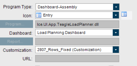

Add it to your menu under Dashboard Assembly.
It will allow to you do stuff like this.

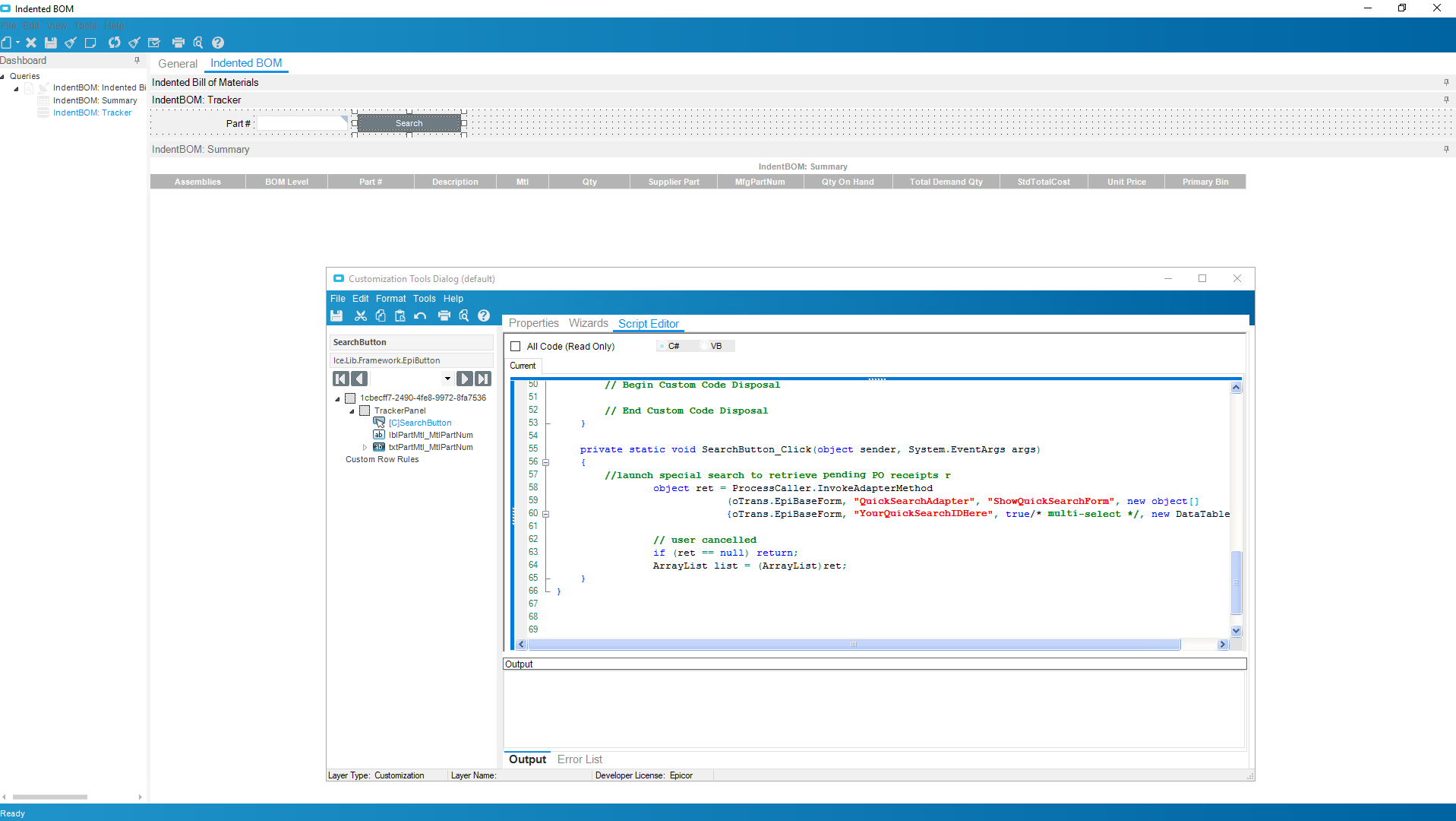

So I assume what you mean, is to leave the button off during the dashboard deployment, and then add it as a customization with a click event where that code is used, and then set it in the menu to use that customization?
Trying it that way gets me some errors within the compile as well. Not sure what I’m doing wrong, but I’m also really noob at this.
Also not sure if its related but when I try customizing it, I get this error. It still brings up the customization screen after though.
Here is the code:
