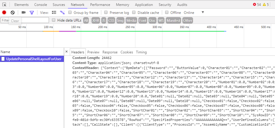

One thing I can give you that will help you in further research is, if you open up the Active Homepage and then go to a browser you should be able to open up http://localhost:1234/ which will open up Chrome Developer Tools for the Active Homepage, and you can monitor the “Network” tab for AJAX Calls and even Inspect the AHP. I think that will answer many questions what Epicor sends in the Header behind the scenes and so on.

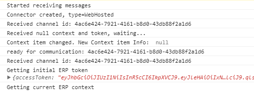

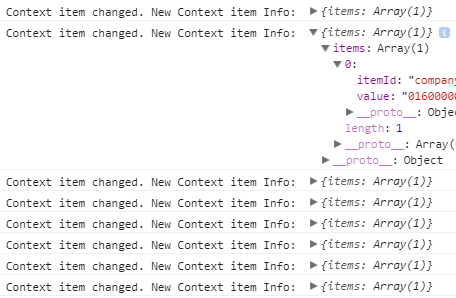

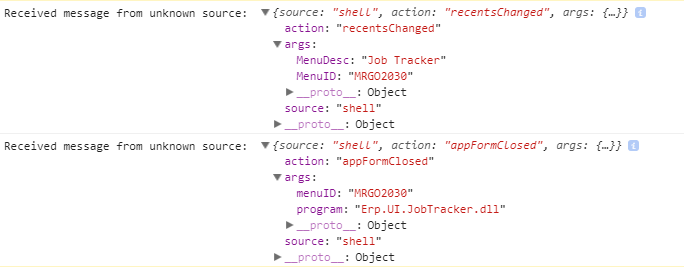

It looks like the Web Application can have special Objects and the Active Homepage can send messages to it, when company changed, when a form has been opened or closed, workstation changed…
It passes through: ?channelid=5c52bc1a-8a7b-4e4a-97c4-ac2b4a5d63b2

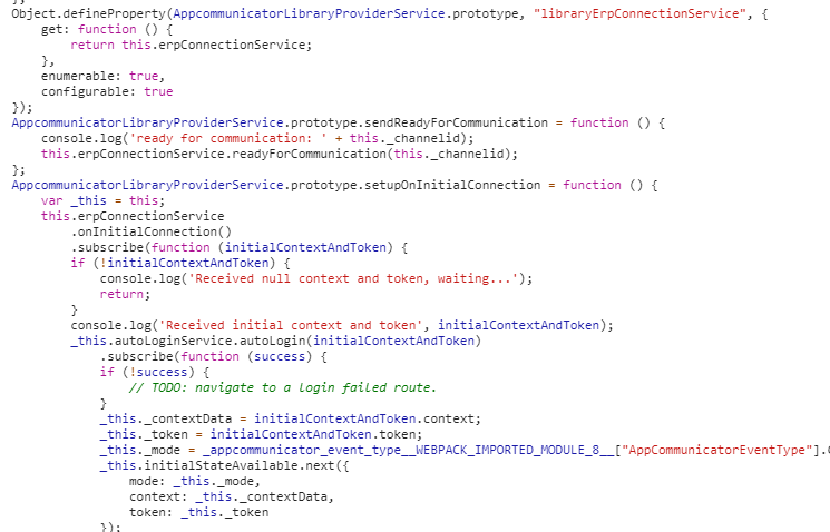

It looks like The Host tries to invoke special methods if they exist on the child (the embedded web app)… (Probably part of Kinetic SDK for now):
Looks like NGRX/RxJs Channels to me. If you change companies or Workstations the Website Widgets get a Full Refresh where the Web Application Widgets simply get notified, not refreshed.

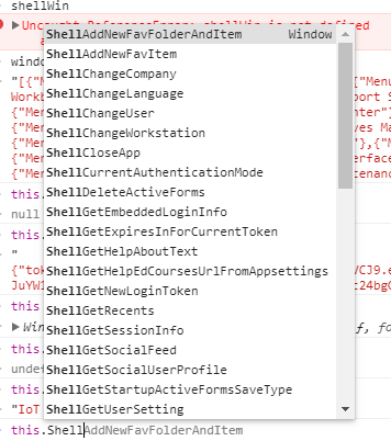

Lastly, you can use regardless which type, a few functions to launch forms and so on.

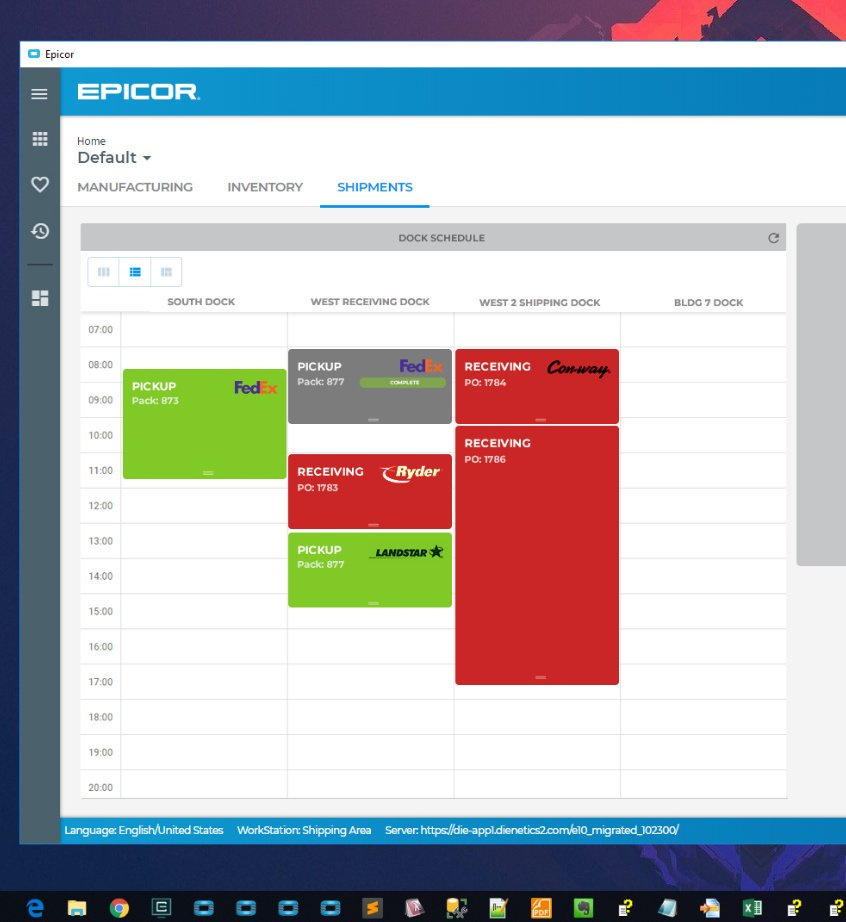

Maybe now I can finish my Dock Schedule App…

ps. @hkeric.wci congrats you’ve figured out our observable over post message comms mechanism. You could make that work btw, but we’re almost certainly going to break your implementation. How we stitch together many separate web application is still evolving.
