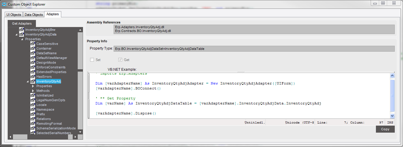

InventoryQtyAdjAdapter adapterQtyAdj = new InventoryQtyAdjAdapter(oTrans);
adapterQtyAdj.BOConnect();
//get by ID?
InventoryQtyAdjDataSet qtyAdjData = adapterQtyAdj.InventoryQtyAdjData;

This is fantastic, thank you Jose! I am curious as to why this solution works though. From what I can see, in my code, I referenced the row, which apparently doesn’t exist in the way I think it does. In your above code, what index are you going after?
I think the function you were using GetInventoryQtyAdj returns a dataset vs the one I used GetInventoryQtyAdjustmentData merges the dataset into the adapter. That’s likely the issue
Same Exact error in Service Connect. Same exact methods called as Aaron did. Unfortunately, GetInventoryQtyAdjustmentData is not an available method to use in the InventoryQtyAdj adapter.
