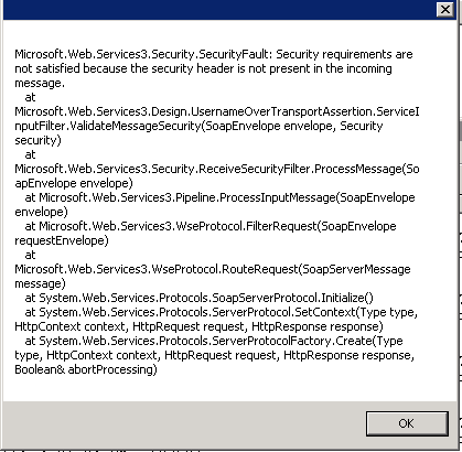

This code fails on client.GetNewOrderHed call and returns the next error:
and I do not see how I can pass a security header in addition to UserName and Password.

You need to read the web services guide available in EpicWeb

If you consume the WSLD as a Web Service Reference and not a “Service Reference” it will generate correctrly
You also have to use the WSE runtime, again all this is in the guide step by step.

As stated in the guide you need to install and use
https://www.microsoft.com/en-us/download/details.aspx?id=14089
Because you are in 9
And when you add the Service you need to add it as a WebReference not a Service Reference (Advanced Options)

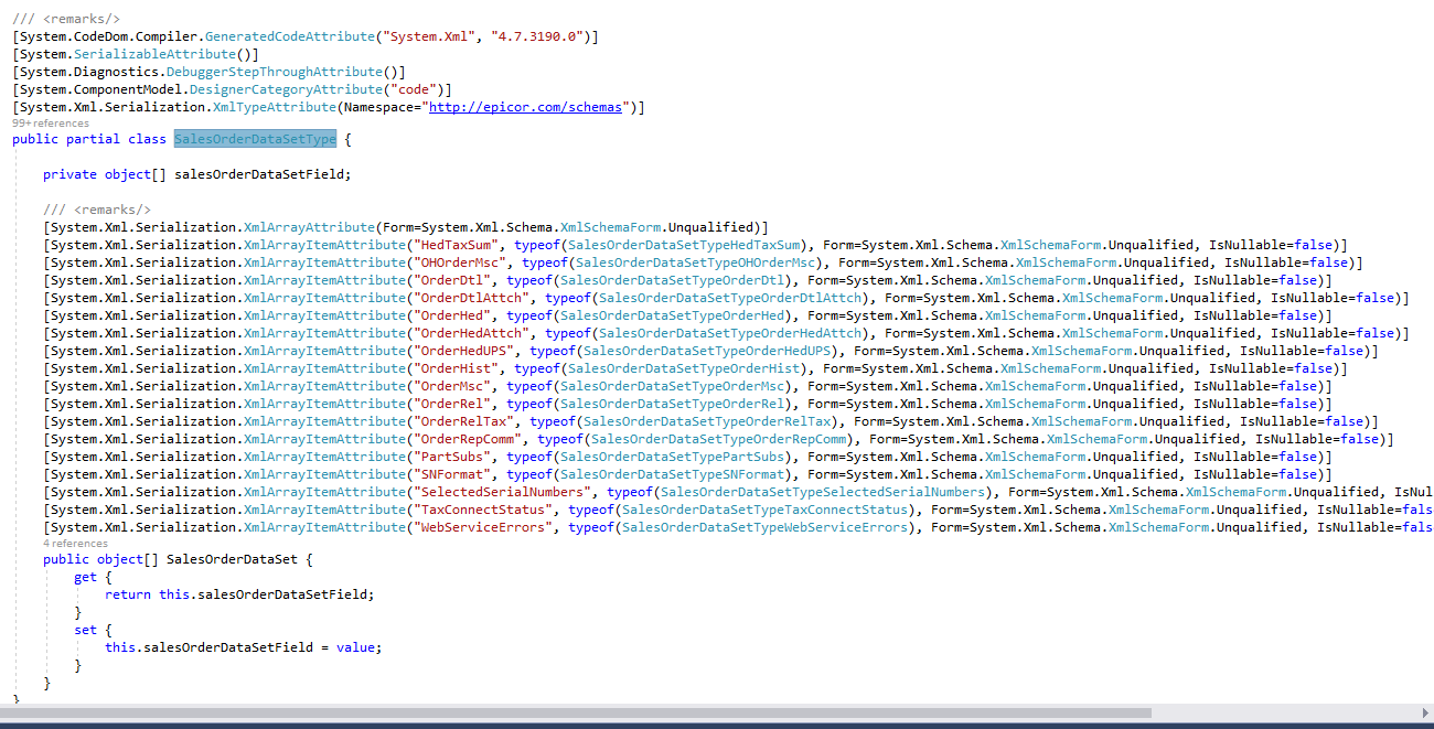

Update. After pocking around I was able to bring SetPolicy to SalesOrderService class by changing the inherited class from System.Web.Services.Protocols.SoapHttpClientProtocol to Microsoft.Web.Services3.WebServicesClientProtocol. I guess the actual problem was that I got it right at first but then re-imported WSDL and forgot to change it again because re-importing will re-write your changes.
Thanks Jose, I am moving forward!=)
Hey @josecgomez, I think I almost was able to post the entire order into Epicor but, it looks like it doesn’t want to process a Detail level information and returns me this error:
At this point, Header was populated successfully but, none of the Details. I think that it might be related to OrderNum on Detail level being passed as 0 but, I do not see how do I specify a Number of a new order that hasn’t been created yet. Unless I have to do two separate calls, one for Header and one for Detail which I did not find available methods to call. Here is how my code looks like:

I confirmed that all the information exists in Epicor and I can create a new order Header and Detail with all those values from UI.
Any thoughts or advice would be very much appreciated. Thank you.

Hi Ken,
Well done. Thanks for sharing your code. It seems like you are doing this through a dll Epicor.Mfg.BO.SalesOrder and Epicor.Mfg.IF.ISalesOrder? As I understand this is not an option when you want to post order through WSDL. I am doing something like this:
First of all here is what SalesOrderDataSetType class is accepting:
SalesOrderDataSetType ds = new SalesOrderDataSetType();
SalesOrderDataSetTypeOrderHed soDSHed = new SalesOrderDataSetTypeOrderHed();
SalesOrderDataSetTypeOrderDtl soDSDtl = new SalesOrderDataSetTypeOrderDtl();
SalesOrderDataSetTypeOrderRel soDSRel = new SalesOrderDataSetTypeOrderRel();

soService.SubmitNewOrder("TEST", ds, callContextIn, out callContextOut);
This is how I am populating objects and trying to send them. I noticed that Epicor is pretty responsive and gives a legit error if you are missing one of the required fields as I got with ShipViaCode. It’s not mentioned in the documentation lol, but it returned me an error that ShipViaCode is required.
