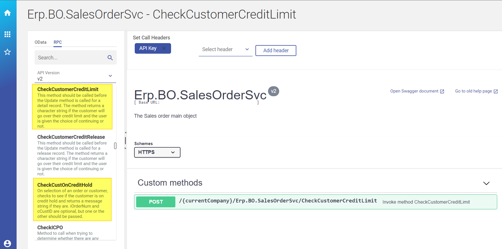

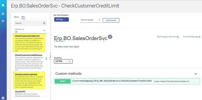

Thank you for that information. Can you clarify where I would find “custom methods of the API”?
On the BO Rest Help page, there is a dropdown at the top right to change from OData to Custom.
Ahhhhah! Learning so much here!
First, I couldn’t find the verbiage “custom methods” because I was using a different front-end where they’re listed as “RPC”.
Secondly, it seems I found the two methods my integration needs to call.
Thirdly… oh, so that’s what that RPC tab is for!
