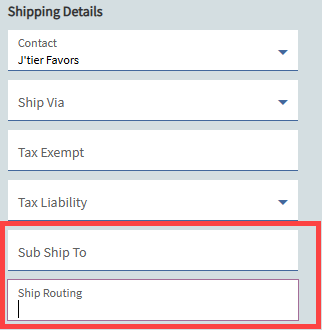

On the sales order release two field exist -
SubShipTo and Ship Routing
These two fields could be leveraged for your use.
In the queue you could assign the material queue to Employees or warehouse teams based on the information in the two release fields.
