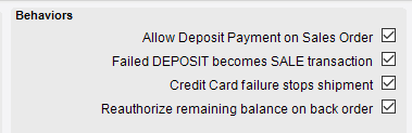

Hopefully your credit card configuration screen has credit card failure stops shipemtn turned on ![]()
