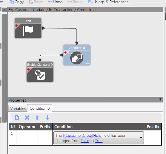

What do you have in your “Customer on hold” InTransaction?
Here in the In-Transaction:

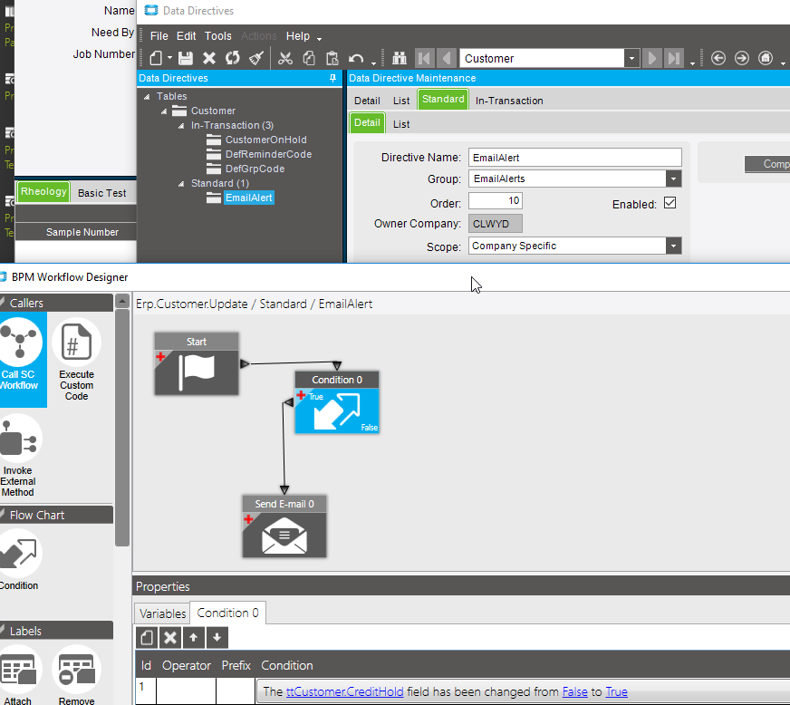

then in the Standard:

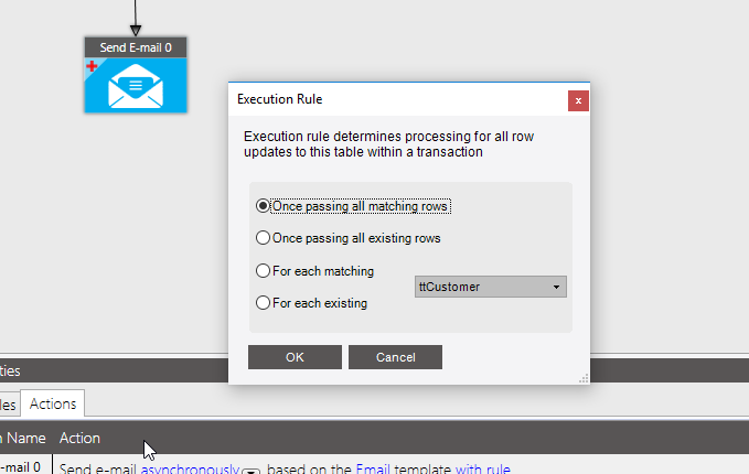

Should the rule be set :slight_smile:
Try sending the email Synchronously. I’ve had issues in the past where asynchronous emails wouldn’t send. This will also display an error to the user if the emails failed to send for some reason, like the SMTP address and port not being set up in Company Maintenance.
I usually use For each Matching…In this case it should not matter has it is one customer …
If an update would be for multiple rows…passing your conditions, “for each matching” would result I think in sending an email for each “matching” row …
and as Tyler indicated… use Synchronous…
