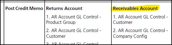

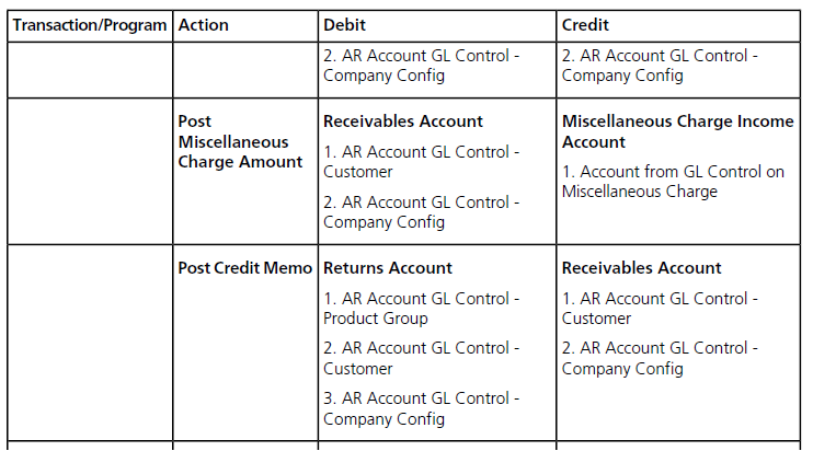

Do you know how to use the AR hierarchy guide? I pulled this from an old version, but I cannot imagine it has changed:
Looking at the CM row above, It should hit the customer’s GL control code, or if there is none (that’s fine), then the Company GLC.

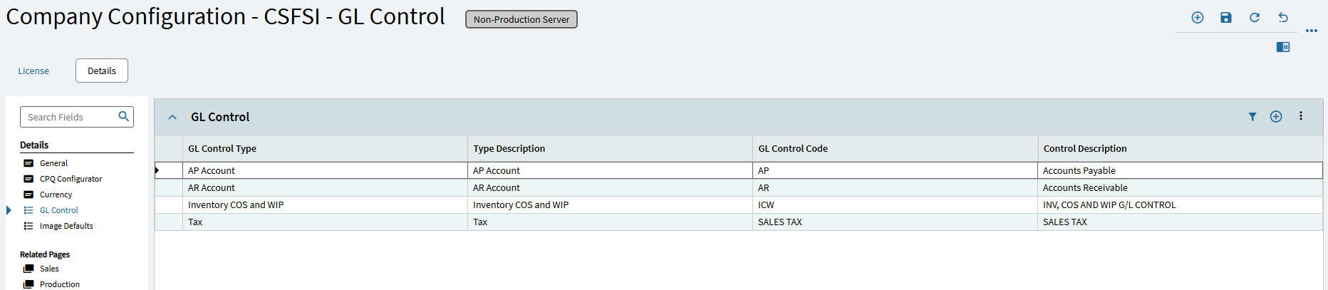

If I’m understanding correctly, the next area I should review would be the GLC (General Ledger Control) defined for the company we’re posting in? If so, is I’ve made it this far.
Assuming I want to drill into the AR Account but not sure what I’d be looking for.
Makes sense. Most of ours do not either.

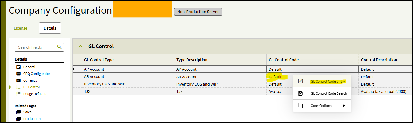

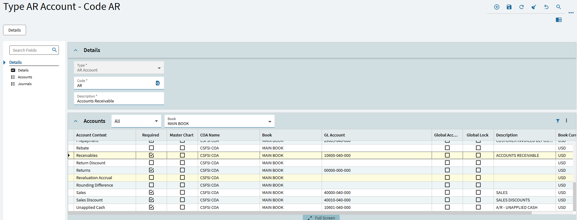

From there, like you said, go to company config; then right-click on the GL Code for AR Account, and open the Entry app. (Someone here 10 years ago decided “Default” would be a great name for everything. :eye_roll: )

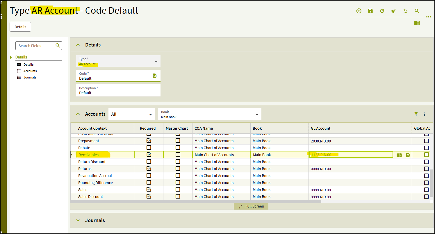

Then you want the “Receivables” row of Account Context (because “Receivables” is what is in bold in the guide here)
For us it’s this account.

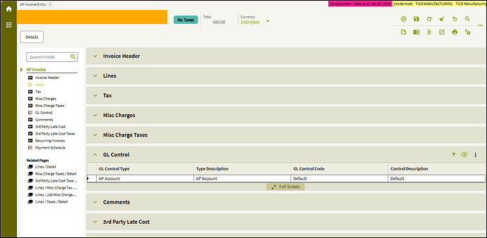

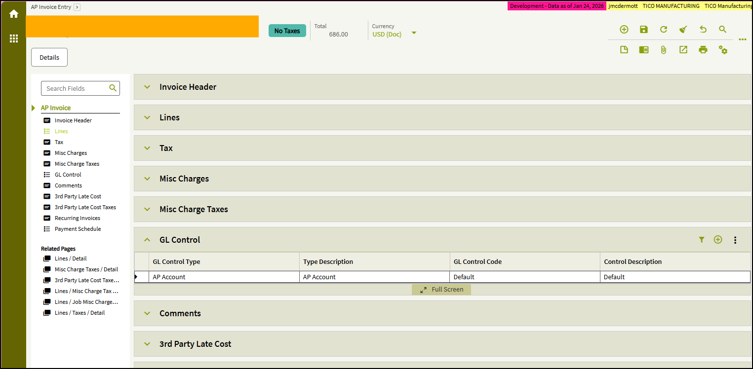

But, I learned along the way that the AP side of the world pulls the GL Code right into the invoice, and you can delete/override it there. Having said that…
What’s interesting to me is that the AR invoices don’t have that feature.
Maybe there is sound reasoning behind it, but I always assume AR and AP will be set up as mirror images of each other.
AP:

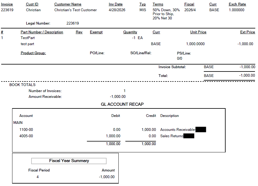

I just did this test and modified nothing:

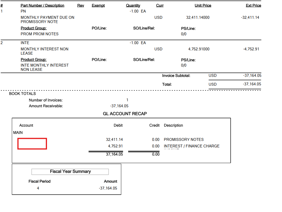

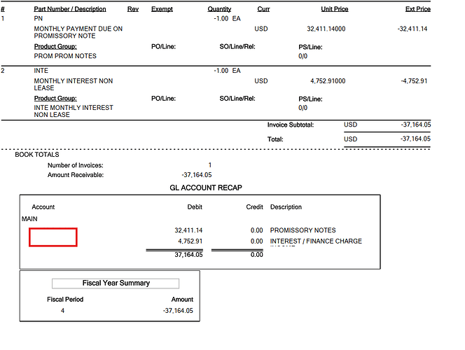

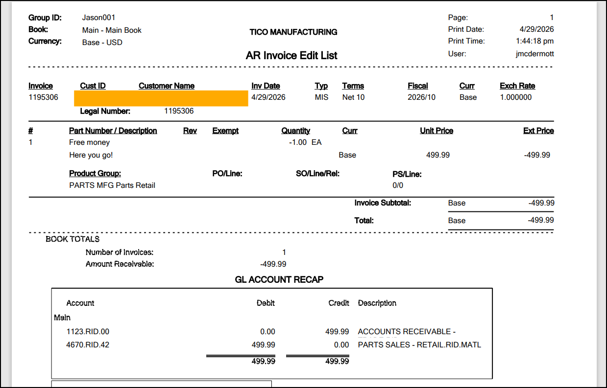

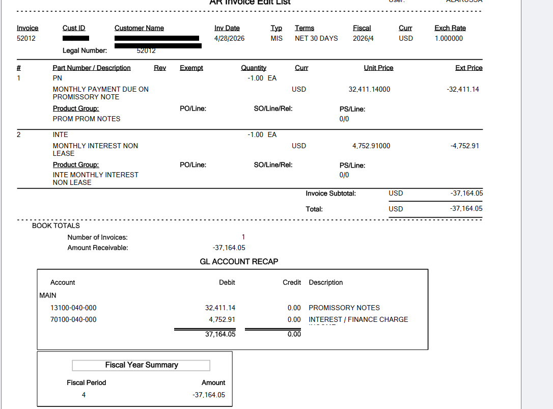

Full Prod screenshot of the AR Invoice Edit List below.
oof. OK, I must’ve misunderstood.
To clarify - if you apply a credit memo to the original order/invoice then everything is good? If you don’t apply it to the order, and use the same customer, even if you manually override the GLs it doesn’t apply a credit?
Something is very fishy here. You have to have one or more credits.

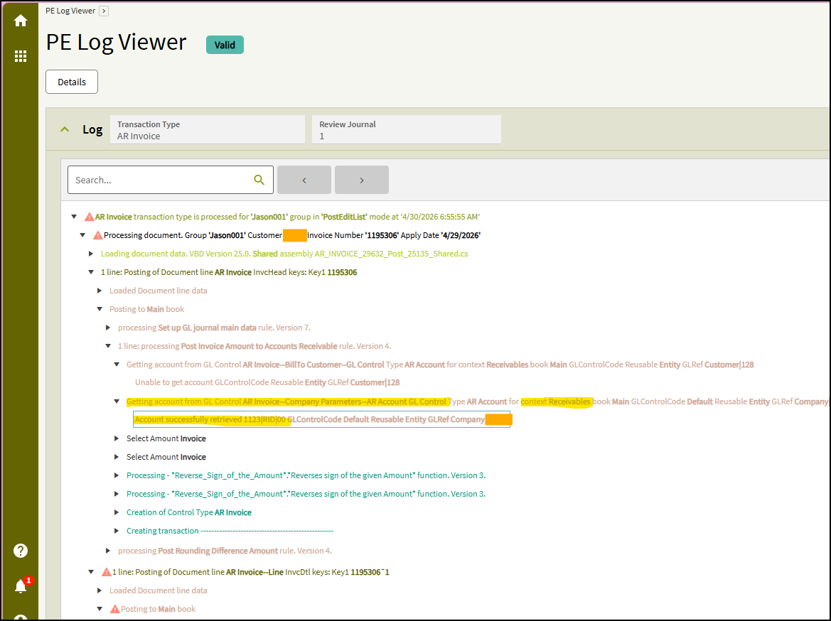

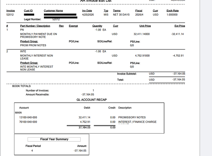

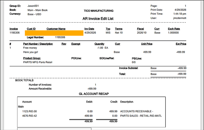

This is the PE Log Viewer; it’s like reading the Matrix - you can get used to it.
Anyway, here is my invoice; it does as the hierarchy guide explained: Customer had nothing so it pulled the Company GLC.

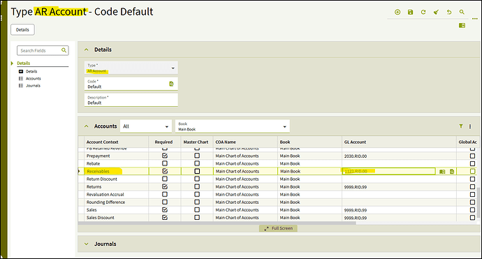

OK, how about this: Is 10600-040-000 a real account? They let you mess up!
Here is an example that I just made. I set a context to an account called 1123.RID.42. This is not a real account in our system; it could be - each segment is valid. And the description makes it look valid. But…
When I look in “General Ledger Account,” it’s not there (with the 42 part).

  2. Use the PE Log Viewer. This may take some explaining…

Lol. Apologies for the late reply! Last evening I created an Epi support case for this one and we just passed along the PE Log.
