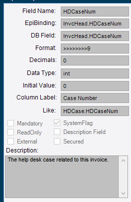

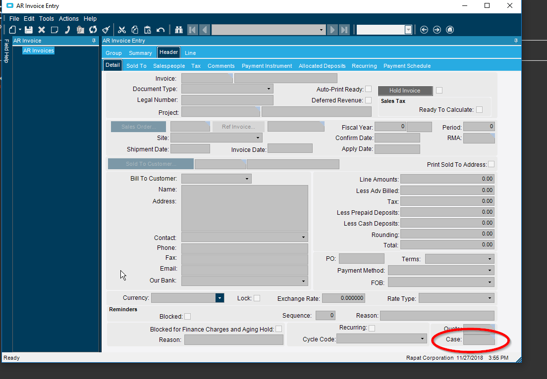

The first requirement that I am being asked to look at is to related a misc invoice (credit memo) to an HDCase. Customer service is trying to see what the total cost of everything related to the case is, I don’t see anywhere on the screen for invoice entry to relate it to the case, but I see that there a field in the database for HDCase. Does that show up anywhere else that someone knows of? All of our invoices show a 0 for that field, so I don’t think anything is automatically being applied on that field.

My current simple plan, is to require Customer Service to request the misc invoice manually (outside of Epicor) from accounting, and accounting will create the invoice. I want to customize the invoice screen to add a control so an HDCase case be linked to the invoice. The only real thing that would change would be to create the customization so that it could be linked.
