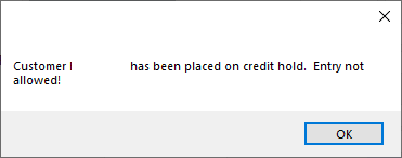

I have a customer that is on credit hold.
The order is marked as credit override.
I can change the dates on the header, but not on a line.
Why?

Ok, I figured something out, but that something still has to be broken.
If the option “Include Open Orders in Credit” is checked, I can’t edit. Off, I can.
There was a post somewhere about it triggering it to be back on hold if that was the case.
But it is NOT putting the order back on hold, so why can’t I edit?
What’s the point of an override if it doesn’t override?

I just tried to test this… in PILOT (2024.1.5)… and it let me change the Line dates when the order was on Credit Override.
So, perhaps a bug that they fixed in the newest version? Hard to believe this would be a bug that never got caught before.
Is your line items a manufactured part? My test was for a stock part coming out of inventory. Wonder if you line may have been for a part that was already on a job or “Make Direct”? Does a credit hold put a hold on a manufacturing job… and you can’t change the date because the JOB is on hold?
In customer credit manager, was the “Include Open Orders In Credit” checkbox checked?
yes
