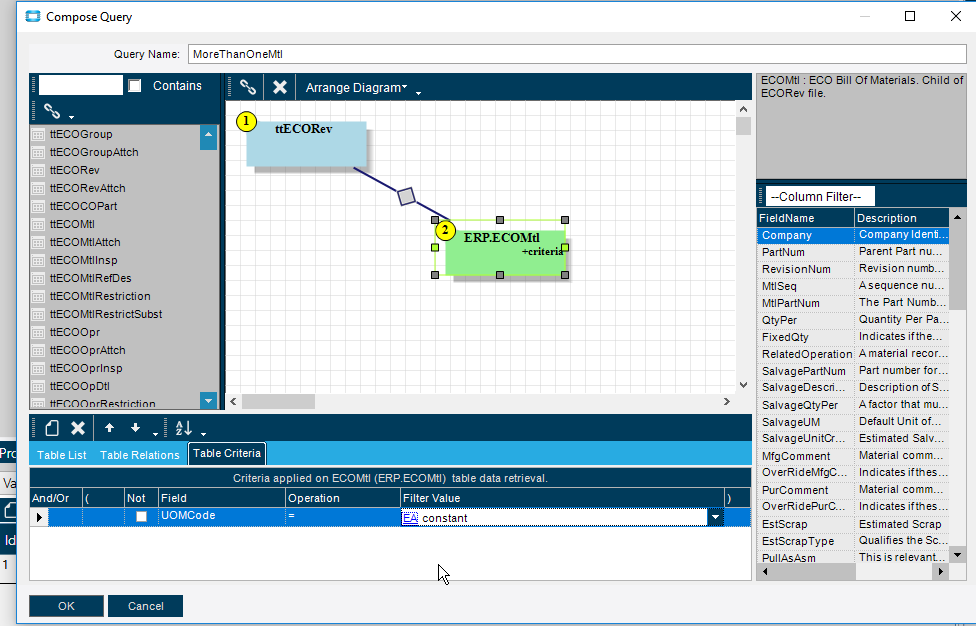

So I am setting up a BPM and I have a condition by query. For some reason, using a condition filtering by a constant is giving me an error when trying to save the BPM. What am I doing wrong?
Here’s a screen shot of the query. I I remove the criteria, it saves and works fine, it just returns more than I want (Hence the criteria). It passes validation, but gives an error when I try to save it.
This is the error I get when trying to save.
I’ve tried adding single quotes, double quotes, using =, = with the not check, matches. It all comes out the same.
Any ideas what I’m doing wrong?
Double quotes should do it, the Query here is no SQL but LINQ
Thanks. I could have sworn I tried double quotes, but I guess I didn’t. It works now.
